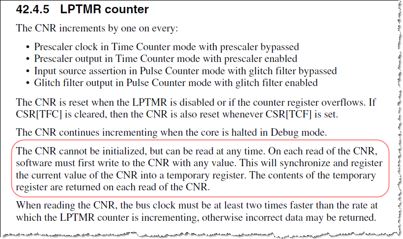

And I check
time = LPTMR0_CNR;
It's always 0. When I set break point and watch the registers - LPTMR0_CNR = 0x0000.

Thank you. Something new to me.  I used to simply read the counter register.

Robin_Shen
Mark is correct, On each read of the CNR, software must first write to the CNR with any value.
You can find the description in "42.4.5 LPTMR counter" of K10P144M120SF3RM.

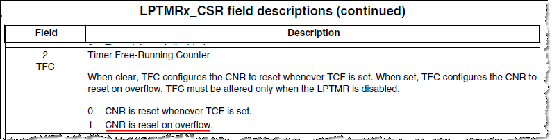

I also notice that you have enable the Timer Free-Running Counter.
When 1kHz LPO is select as clock source. You may need to wait 65536ms , then run into LPTMR interrupt.

mjbcswitzerland
Specialist V
Hi Evgeny
    unsigned long ulCnt;
    LPTMR0_CNR = 0;  // write any value to the counter register so that it puts its present counter value into a temporary register
    ulCnt = LPTMR0_CNR;  // read the value from the temporary register
If you read the register description in the manual you will see why. If you check the uTasker open source project you will probably already get all answers too.
