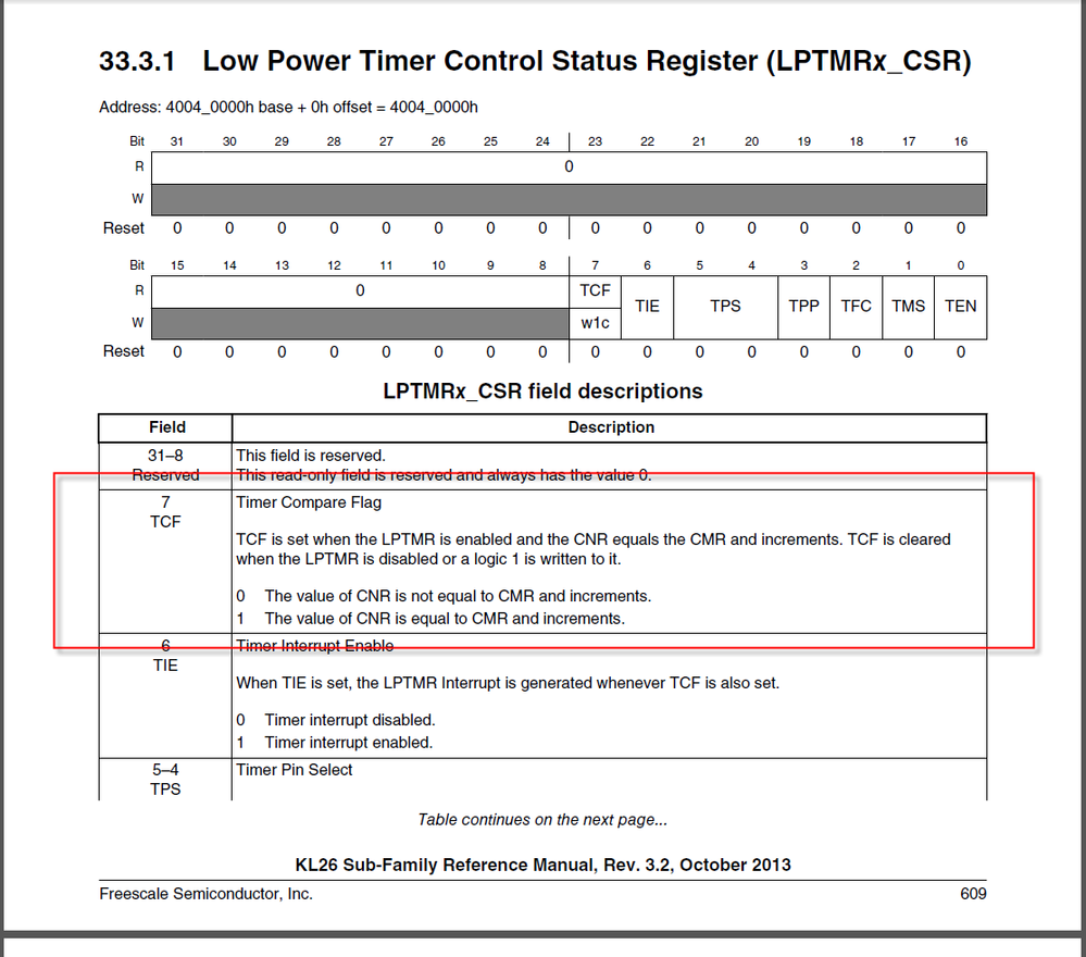

Kan_Li
Hi Yar,
Have you enabled the interrupt and clear TCF flag in the ISR? Because on overflow event, CNR is reset whenever TCF is set.

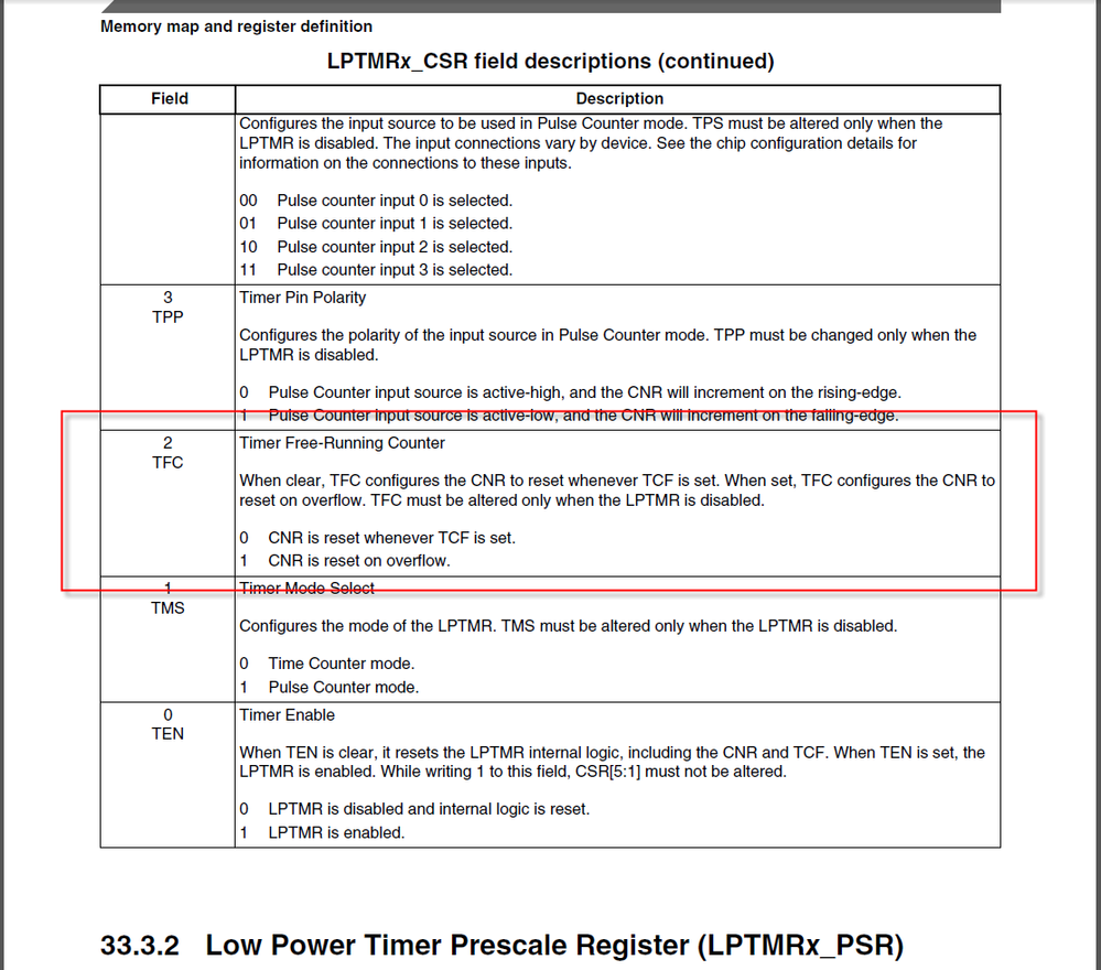

Kan_Li
Hi Yar,
The flag to be cleared in ISR is TCF bit, TFC bit is for selecting the case when CNR should be reset, you may fetch details from the RM like the following:
so you should clear TFC flag when initialize LPTMR, and in the ISR write one to TCF flag to let CNR continue to count instead of resetting.
