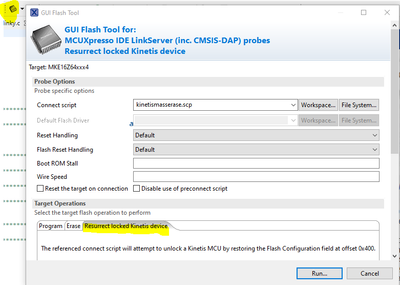

4,637 Views
Kaarthi
Hi Diego,
Yes, I am first time debugging this chip.
I have already this unlocking procedure with GUI Flash tool. Still its not working. Please tell me how to do a ROM bootloader thing.
Below is the console thing for unlocking,
Executing flash operation 'Resurrect locked Kinetis device' (Resurrect locked Kinetis device) - Tue Jul 27 22:59:52 IST 2021

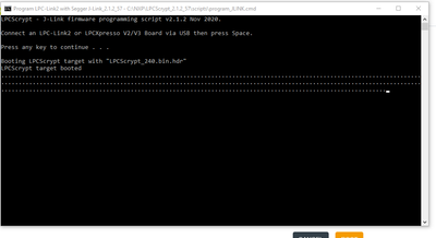

4,600 Views
Kaarthi
I am not able to program the LPC Link2 I am getting like this,
I checked the reference guide, it states to ensure the VCOM driver, so I checked it also as below,
So kindly guide me in this...
kaarthi
4,548 Views
diego_charles
Hi @Kaarthi
Thank you for letting me know your results. Did you continue to have more problems to update the LPC-Link 2?  You could refer to section 8.2 My device DFU boots but then just prints ‘......’of the LPC-Link2 Debug Probe
Firmware Programming User guide.
