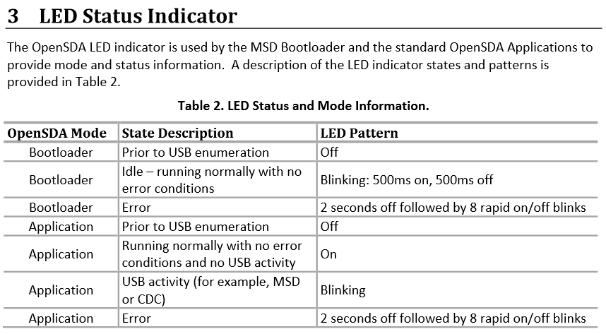

I'm checking a KL25Z board that neither Windows or Linux recognize. The only symptom is a 8-times blinking, 2 or 3 seconds paused and again 8-times blinkings.
What can be the problem?

As you can see in the OpenSDA user guide​, it means that there is an error with the bootloader or the application.
Have you tried to reload the OpenSDA application (Section 2 in the OpenSDA user guide​)?

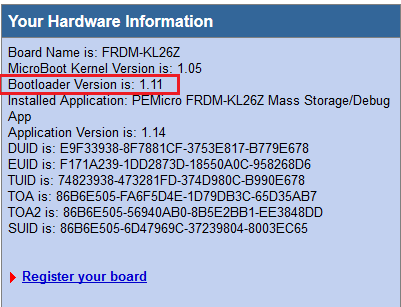

That SDA_INFO.HTM says that the bootloader v1.11 (which is the file "BOOTUPDATEAPP_Pemicro_v111.SDA") is not installed. Did you try to install it?

Your HW Info still shows that the Bootloader version is 1.09 and not the updated version is 1.11.
See below... this is what you should have instead if you're correctly updating the Bootloader before you install the PE Micro OpenSDA.
Try this and let me know if this helps.
Extract the ZIP file that Earl sent you before into a folder. Make sure that you have these two files are extracted and saved in a folder. This is the key thing that we often ignore and trying to drag the file straight from the Zip folder, don't try that!!
First install the "BOOTUPDATEAPP_Pemicro_v111.SDA" by pressing the usual RESET button procedure which you know already. Once done that, unplug the USB cable and plug it back... this time do not press RESET button when you plug in!!  Now you should see a removable drive with the label similar to this FRDM-KL25Z (D:) and now once again check the SDA_INFO to make sure the Bootloader version is updated to 1.11.
Once it is there, you can continue to copy the next file  "MSD-DEBUG-FRDM-KL25Z_Pemicro_v114.SDA" into this drive without unplugging the cable. When finished copying you can unplug and pulg it back... do not press the RESET button!  If you follow these steps correctly your board should be up and running with the correct PE Micro OpenSDA debugger. Good luck!

No, after copy "BOOTUPDATEAPP_Pemicro_v111.SDA" and reconnect without pressing reset button, I can see a drive labeled BOOTLOADER and this is the info:
Board Name is: FRDM-KL25Z
MicroBoot Kernel Version is: 1.05
Bootloader Version is: 1.09

It seems board is not upgrading its bootloader version, despite I'm copying a new version.

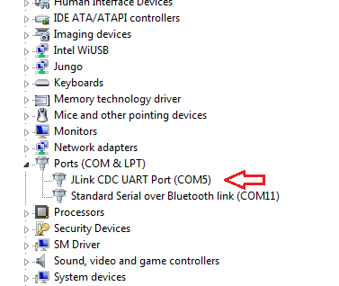

Can you try to install a different OpenSDA debugger, (e.g. J-Link Open SDA) and see if that works on your brd?
In the BOOTLOADER mode, copy the attached file (JLink_OpenSDA_2015-06-11.sda). Once copied unplug the USB cable and plug it back. Check the Ports under Device Manager. See the screenshot below for what I see at my end. Pls let me know if you get the same results.

I don't see any "JLink CDC UARD Port", only a COM1 port :smileysad:
