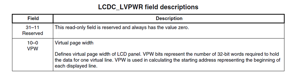

peterilsoeniels
The solution was to set the virtual page correct up. My new best friend Martin has spotted that the virtual page is in 32 bit words:
Meaning that the virtual page should only be half the size.
// set LCD virtual page width
  LCDC_LVPWR = LCDC_LVPWR_VPW( SCREEN_XSIZE/2 ); //Peilni: this number is in 32 bit words, since we use 16 bpp is should be the half siz

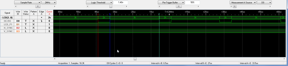

peterilsoeniels
Hi Kan,
I have tried to changed them to GPIO no luck:-(
I will try to measure the timing of OE.
Br. Peter
6,918 Views

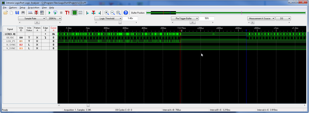

peterilsoeniels
I have tried to measure the timing of OE or DE as the Panel data sheet call it:
From data sheet:
Blanking:     (1/30e6)*192          =     6.4us
Measured                                 =     6.5 us
Active:     (1/30e6)*800               =      26.67us
Measured                                  =      27us
The vertical timing is all so okay see picture:
From data sheet:
Typical timing:      (1/30e6) *20*992      =      661.33us
Max:                    (1/30e6) *20*1090   =       726.67us
Measured:                                         =       700 us
So in my view the timing is okay.
Best regards Peter Ilsoe
