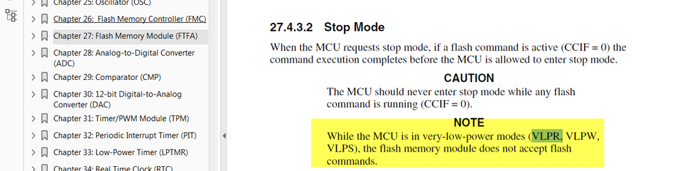

   The KL15 can't support the flash program in the VLPR mode, please check the KL15 reference manual:
Sorry for the inconvenience we bring you.

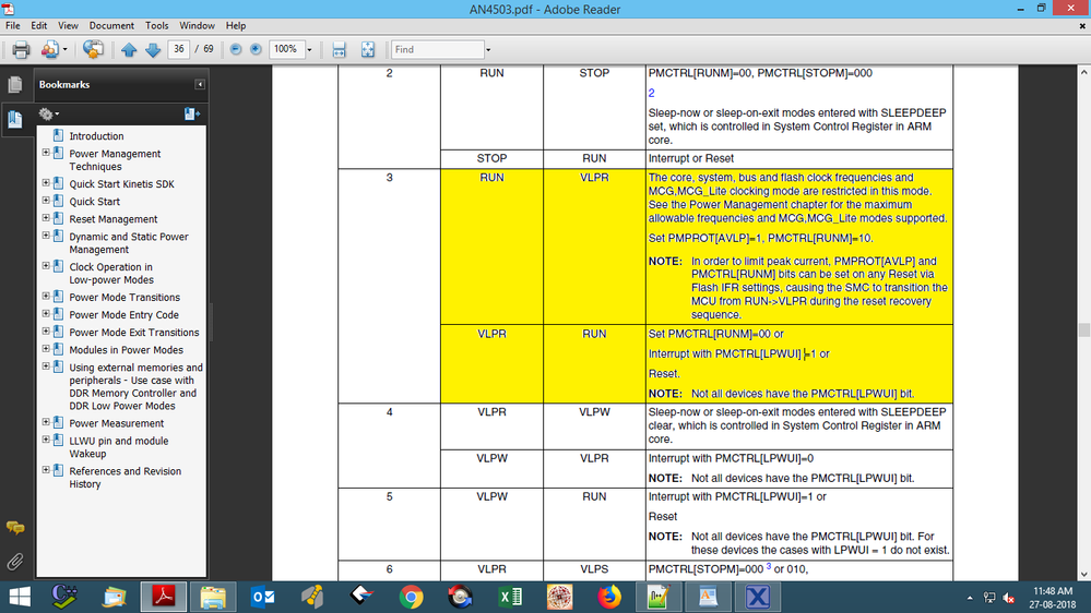

Is it require to set clock every time switching the power mode? Because AN4503(8.1.1 Entering and exit conditions for each low power mode,page 36) does not mentioned this.
As per AN4503, we need to modify PMPROT[AVLP]=1, PMCTRL[RUNM]=10 to switch from RUN mode to VLPR mode which is handled by SMC_SetPowerModeVlpr(SMC);
And modify PMCTRL[LPWUI] =1 which is handled by  SMC_SetPowerModeRun(SMC);
But the SDK example code uses APP_SetClockVlpr(); and APP_SetClockVlpr(); Is it really required?

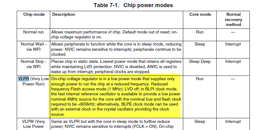

    Please check the KL15 reference manual, chapter 7: power management, you can find the VLPR have the clock limit, that's why we tell you do the clock switch:
So, please refer to the KL15 sdk code, that is really what you need.
