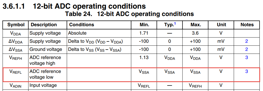

Hi, i'm trying to maximize the sensitivity of the ADC using a  specific range of reading, between Vrefl and Vrefh, and make this range output full VSS-VDD in the DAC, for example:
Signal Range = 1V — 1.5V
Vrefl = 1V
Vrefh = 1.5V
Reading expected:
(Input) = (Reading)
0V  — 1V = 0x0 (Saturated Region)
1V — 1.5V = 0x0 — 0xFFF (Usefull Region)
1.5V — 3.3V = 0xFFF (Saturated Region)
Output Expected
(Input) = (Output)
0V  — 1V = 0V (Saturated Region)
1V — 1.5V = 0V — 3.3V (Usefull Region)
1.5V — 3.3V = 3.3V (Saturated Region)
Vrefl and Vrefh should be standard references for ADC, for full output i made DACx_C0[DACRFS] = 1.
What i got was:
Reading:
0V — 0.5V =  0x0 — 0xFFF (Usefull Region)
0.5V — 3.3V = 0XFFF (Saturated Region)
Output
0V — 0.5V =  0V — 3.3V (Usefull Region)
0.5V — 3.3V = 3.3V (Saturated Region)
So, the ouput was ok, could make full range, but couldn't make the reading in the range expected, the range was like VSS — (Vrefh-Vrefl) = 0V — 0.5V = 0x0 — 0XFFF
Maybe the low reference for ADC will be Always VSS , can someone confirm this?
Why the high reference for conversion seens to be (Vrefh - Vrefl)?

Hui_Ma
The KL05 datasheet ADC module operating conditions with below requirements of VREFL and VREFH:
VREFL is fixed to VSSA.
Wish it helps.
