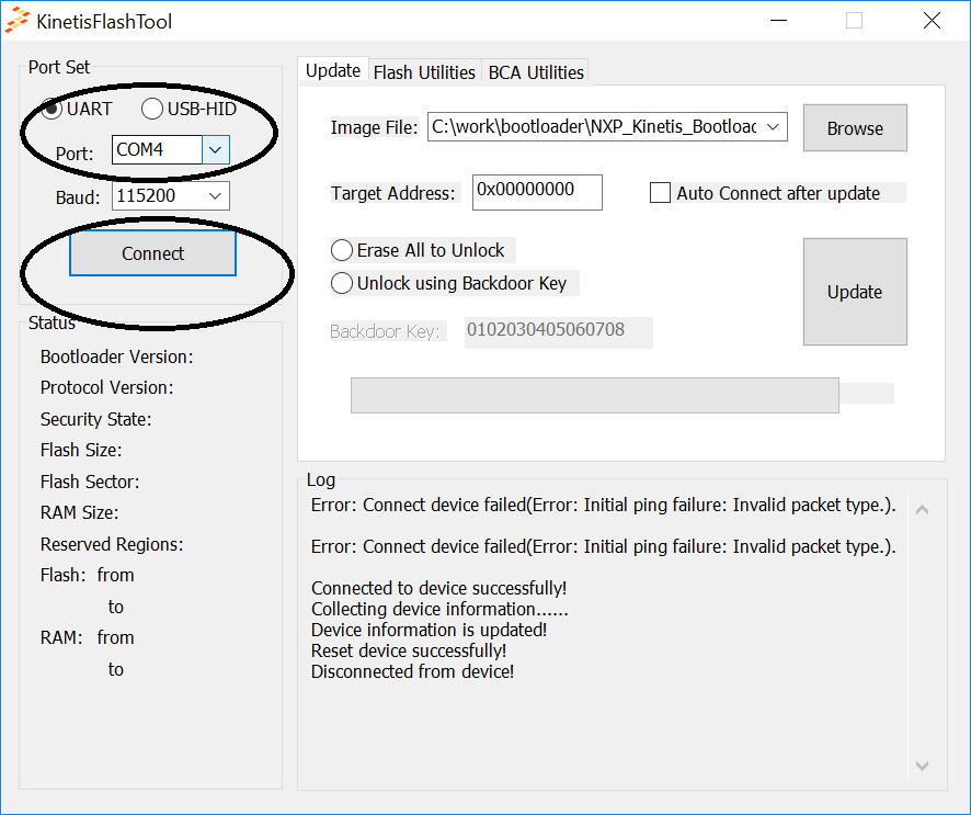

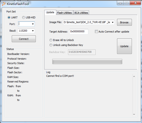

How to config the MKE18F512VLL16 to use the KinetisFlashTool?
1,946 Views
lifeng
For  TWR-KE18F,  connect  the usb port to computer. Then select  the UART port which create by the openSDA serial and debug adaptor, press the reset button and sw2 button(PTD3,NMI, BOOTCFG0), release reset button and hold sw2 pressing and click the Connect button. The tool will try to connect to the board. Baudrate is not important.
1,946 Views
jingpan
temp.pngHi Li,
If you use TWR-KE18F, just connect  the usb port to computer. Then select  the UART port which create by the openSDA serial and debug adaptor, press the reset button, and click the Connect button. The tool will try to connect to the board. Baudrate is not important.
If you use your own board, you should connect your computer to the LPUART port which list on page 565 in reference manual.
If the connection can't established, you can make a full erase. Then it will be ok.
