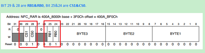

Hui_Ma
Hi Marc,
I got the confirmation mail from Kinetis product team. For your issue, Please set both [RB1] and [RB0] at NFC_RAR register, when you are using NFC_CE1.
Wish it helps.

Hui_Ma
So far, we found a document issue at Kinetis 120MHz NFC module.
The NFC_RAR with the incorrect bit position for RB and CS, please check below picture for the detailed info:
Sorry for the document issue may cause any inconvenience to you.
Thank you for the attention.
best regards,
Ma Hui

bowerymarc
Contributor V
when will you issue an errata with this change, as it directly contradicts the reference manual?
8,237 Views
Hui_Ma
Hi Marc,
That will be ok to post a notification at reference manual.
I will forward related info to Kinetis document team.
Thank you for the comments.
best regards,
Ma Hui
8,237 Views
bowerymarc
Contributor V
Hi Hui Ma,
Again, I have found that you can NOT use both [RB1] and [RB0] in NFC_RAR when using CE1.  I found that if you do that during a block erase, you erase BOTH of your NAND chips at that block.
Marc
