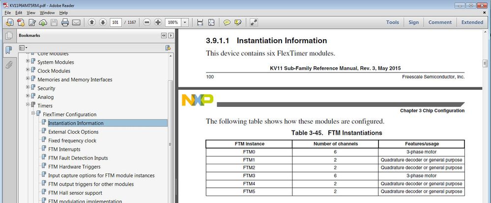

Is there a Kinetis series Microcontroller with 3x independent QUADRATURE encoder inputs?
I need to controller 3x BRUSHED servo motors simultaneously via one microcontroller, so it would also need 6x PWM outs.
1 返信
1,215件の閲覧回数
Robin_Shen
Hi Kris,
You can have a look at KV11.
The Reference Manuals can be download from this website.
Robin
