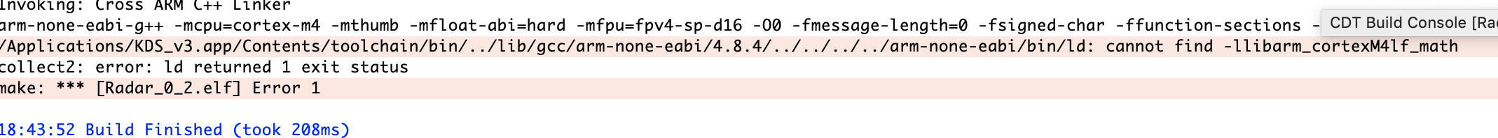

But I can't get the libary working. Everytime the IDE says, it can't find the the libary.
Is the libary not supported? I tried it in windows, macos and linux.
I do something wrong.. but I don't find the solution...

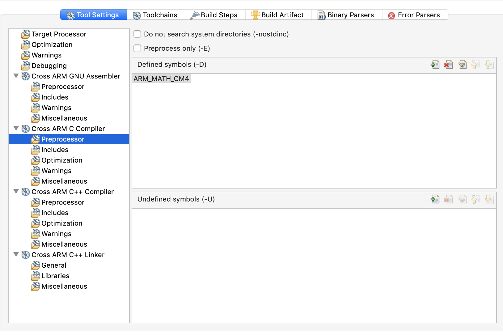

I attached some pictures of the configuration. The libary and and include files are located in the project folder. I defined the libary and set the link to the libarys. But the compiler doesn't find it.

The library name is without the 'lib' prefix and without the '.a' suffix. In this case you should add the library as:
arm_cortexM4l_math
Hope it helps!

But i just realized. that i get another failure code this time:
/CMSIS/DSP/Lib/GCC/libarm_cortexM4lf_math.a: file format not recognized; treating as linker script
/CMSIS/DSP/Lib/GCC/libarm_cortexM4lf_math.a:1: syntax error
I used the newest CMSIS (CMSIS_5-5.5.1) driver from ARM. Is it possible, that KDS doesn't work with this version? Or maybe there is a bug in the libary.

But I finally got it working. Like I thought there is a problem with the newest CMSIS driver and KDS.
I downloaded the Legacy CMSIS version 4.5.... and Hey, now it works perfectly.
Case closed.
