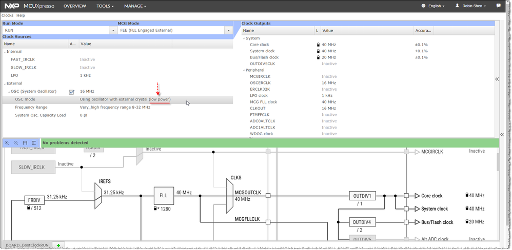

Have you try to configure the OSC mode to “Using oscillator with external crystal (low power)”?
I only have the TWR-KV11Z75M board, the crystal on it is 10MHz. After configure the OSC mode to “Using oscillator with external crystal (low power)”, the PTC3 pin can output OSCERCLK waveform.

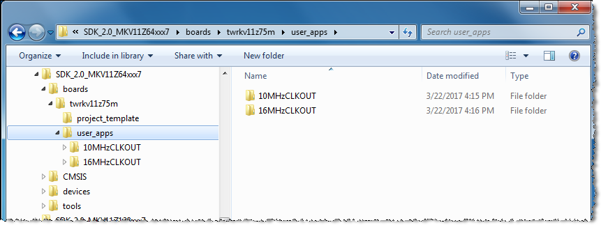

I attached "SDK_2.0_MKV11Z64xxx7_CLKOUT16MHz.zip" here.
I have test the project "10MHzCLKOUT" on TWR-KV11Z75M board. You can try to test the "16MHzCLKOUT" on your custom board.

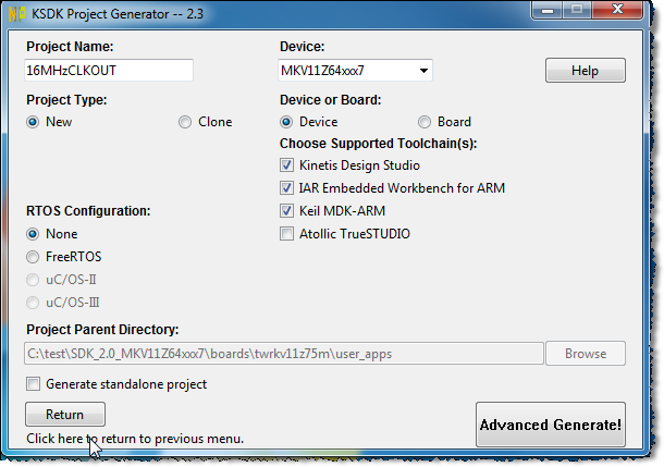

These two projects was generated by using "KSDK Project Generator(REV 2.3)" tool.
