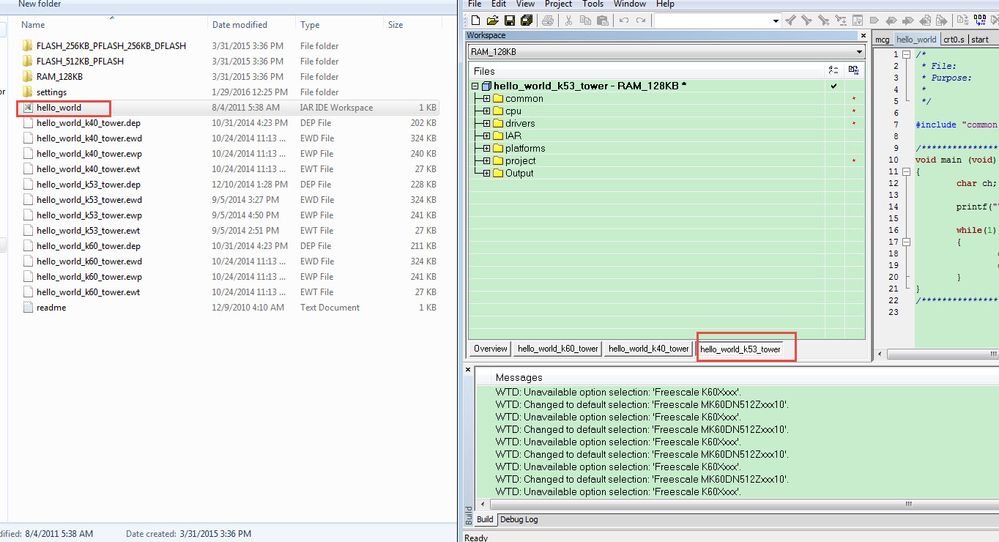

Is there a starter project for the K53N512 (Tower system) that can be used in IAR EWARM without Freescale's MQX? I am using IAR EWARM 7.50.1.10273.

    Please refer to the attached sample code for TWR-K53N512. !
    You can find the according code in folder KINETIS512_SC\KINETIS512_SC\build\iar, take hello_world as an example:
Wish it helps you!

Jingjing, The code you posted was exactly what I was looking for. I'm up and running now.
