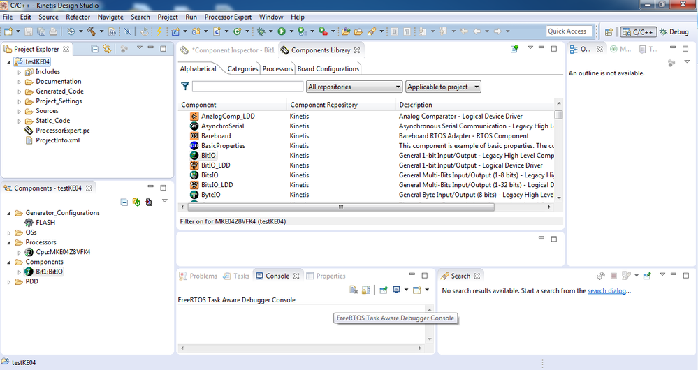

xiangjun_rong
Hi, Bianca,
I have used the KDS tools, and have built a project, I can use PE with the the KDS tools based on KE04.
Hope it can help you
Xiangjun Rong
3,239件の閲覧回数
xiangjun_rong
I attach the screenshot of PE based on KE04 and KDS tools.
xiangJun Rong
