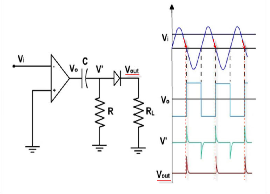

I am currently using a PWM output on my MK22FN512 to tone a speaker based upon a measured signal from an antenna. I update the speaker about every 500 msec to 1000 msec and only use 100 Hz to 3000 Hz mapped to signal power (using a log function but that doesn't matter).
On frequency changes, I get a little click and I am sure it is my software "FORCE" update of the PWM registers. I am not a motor control guy but there must be a way to change the frequency just as the sine wave crosses zero for no disruptions. It is not critical for me but would be a nice bug fix before I release the product.
I will dive in to the datasheet but I thought I would reach out to the community.

This is a good idea (if I need to rev my hardware) but unless my final testing shows an issue, the board is ready for production. I would have thought there must be a way in software to arm a PWM frequency change and have it load at an optimal time (which I guessed was zero crossing). I will keep looking at motor control examples just in case. Thx

Hello Gary,
Have you tried to use a common cross zero point detect circuit. The final output is a trigger signal you can connect to your MCU.
Hope it helps!
