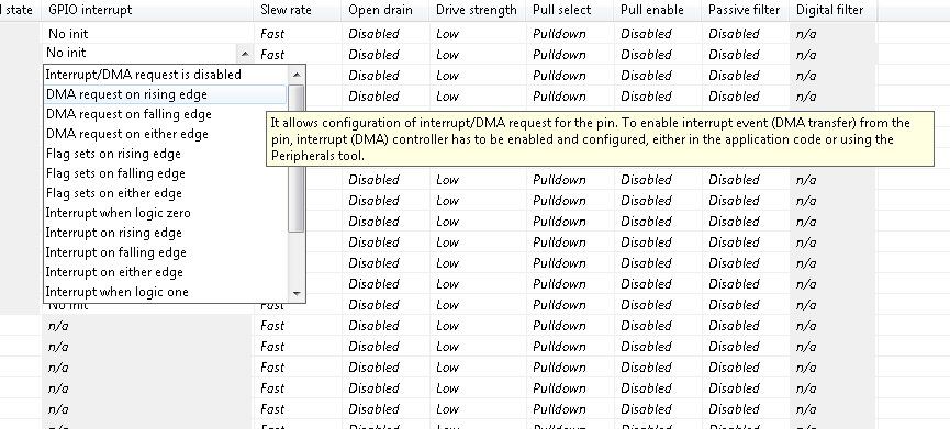

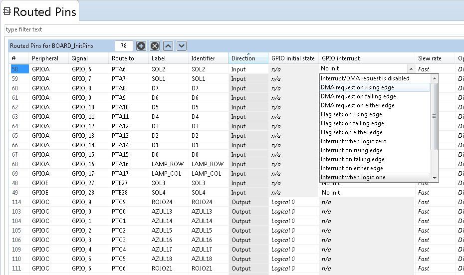

I think you're working with KDS, and the libraries may be different from the ones used by MCUXpresso.
I have opened MCUXpresso, and in the "Pins" option, it seems that I can assign a DMA interrupt to the input ports, maybe this will configure me the same but using the MCUXpresso libraries. Problem is that need enabled and configured interrupt DMA and the Peripheral Tools seem its not available for Kinetis MK66, so need codify manually.

Thanks Mark.
Yes, as far as I understand, in this case using the DMA would not bring advantages, I would have to use common interrupts assigned to each port that should trigger the capture of the 8bit data bus in the GPIO.
I can configure the interrupts in MCUXpresso from the "Pins" tool, which generates all the source code automatically. I just needed to know how to read the state of the 8 pins, with a single instruction, since before I did it reading one by one each pin, and also reading one by one each of the control bus pins. It was slow and did not work well, probably because the data entered faster than the program was able to read.
Now in the interrupt is already identified the signal that caused the interrupt, and with the way you have indicated me to read the 8 pins with a single instruction, I think that must work all right.
In any case, I appreciate the information about the configuration of the DMA, I'm sure it will be very useful for other programs.

About your suggestion using  unsigned char ucDataBus = (unsigned char)(GPIOA_PDIR > 8);
Is it possible to read the status of each pin, with only one GPIO reading, to load them into an array of 8 elements?
9,137 Views
luishs
Senior Contributor I
Thanks, I will use PDIR.
Sorry, but I do not understand how trigger the DMA with six signals (GPIO pins), if possible, to capture my data bus.
I understand that the limit of DMA trigger is one signal, then I can not use six different signals (GPIO input pins) to trigger same DMA to capture 8 GPIO pins. Or I have misunderstood what is the DMA trigger limit.
9,138 Views
luishs
Thanks mark.
Then it is not possible to trigger the GPIO data capture, using several ports as triggers to capture the same GPIO data (8 pins)?
The problem is that I have an 8 bit data bus, and a 6 signal control bus. Each time one of these 6 signals is set to a low logic level, it tells me that I have data on the data bus, and that I must capture it.
I thought I could do it with the DMA, but for that I must be able to trigger the capture of the 8 pins of the data bus, with 6 different signals from my control bus.
Is it not possible to do this with the DMA, is only a hardware signal possible to trigger the DMA?
