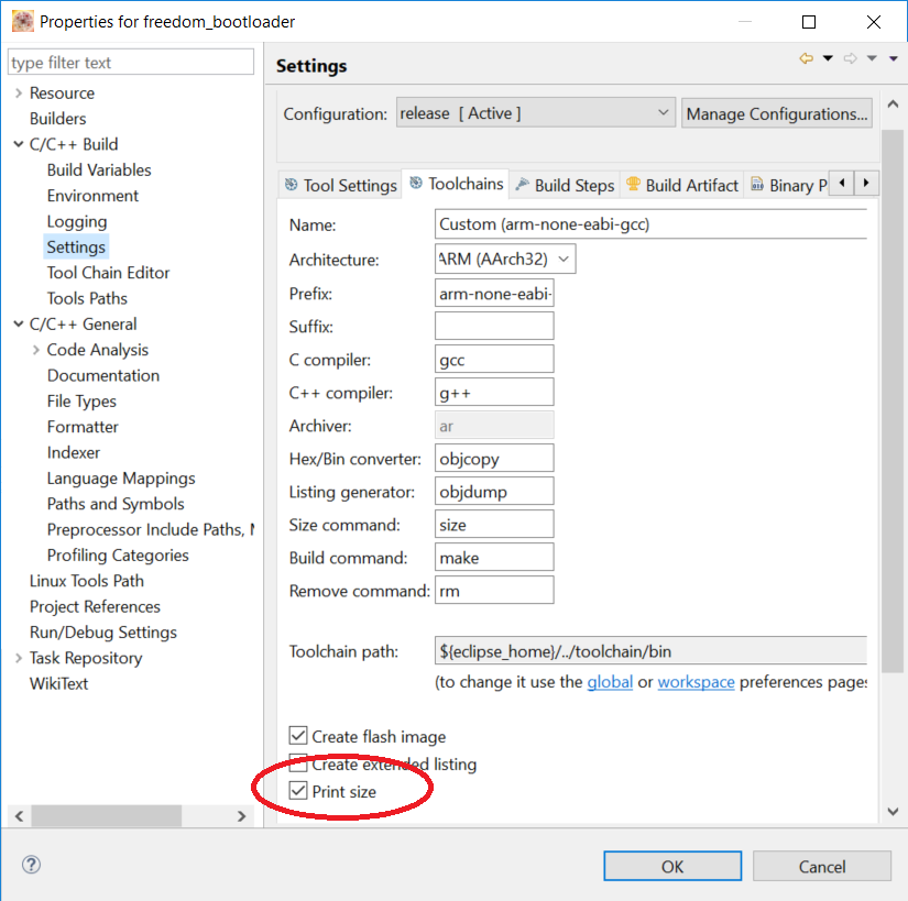

2-) Used RAM and flash size calculation? In the internet it was calculated as below.
 text+data = Flash size; bss+data = Ram size.
Is it true? is there any way to see RAM and flash size as % or any other format .map file or in IDE?
Yes, this is right. You can let console window print size.
It seems the gcc linker in KDS does not support - Xlinker -print-memory-usage. Please refer to below link.
https://community.nxp.com/thread/301618
