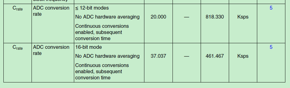

allenwong
Anyone has this information?
My customer is evaluating KM3X MCU series and he want to know what is the sampling rate for this KM3X series.
I check in the data sheet but no information on the sampling rate.
Any idea where can I get it?
1,876 Views
Hui_Ma
Hi Allen,

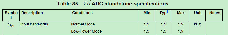

KM3x product has two ADC modules, please check below pictures about ADC conversion rate:
ADC module:
ΣΔ ADC module:

allenwong
Hello Hui Ma,
Thanks for the continuous support.
