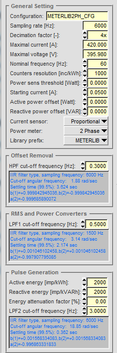

The meter definition used for this application can be found in the meterlib2ph_cfg.h files, this file was generated using the Filter-Based Metering Algorithms Configuration Tool, for more information on how to use the tool you can refer to the AN4265 document.
This is the Meter configuration:

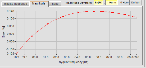

Here you can see the expected error behavior against Frequency:

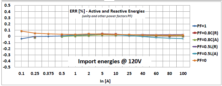

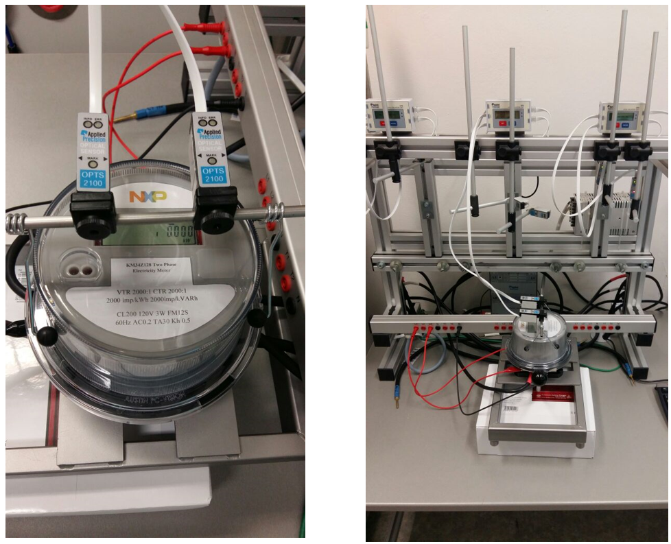

The two-phase hardware has been calibrated using the test equipment ELMA8303. During accuracy calibration and testing, the power meter measured electrical quantities generated by the test bench, calculated active and reactive energies, and generated pulses on the output LEDs; each generated pulse was equal to the active and reactive energy amount kWh (kVARh)/imp3. The deviations between pulses generated by the power meter and reference pulses generated by test equipment defined the measurement accuracy.
The next figure shows the calibration protocol of the power meter. The protocol indicates the results of the power meter calibration performed at 25 °C. The accuracy and repeatability of the measurement for various phase currents and angles between phase current and phase voltage are shown in these graphs.
The first graph indicates the accuracy of the active and reactive energy measurement after calibration. The x-axis shows variation of the phase current, and the y-axis denotes the average accuracy of the power meter computed from five successive measurements

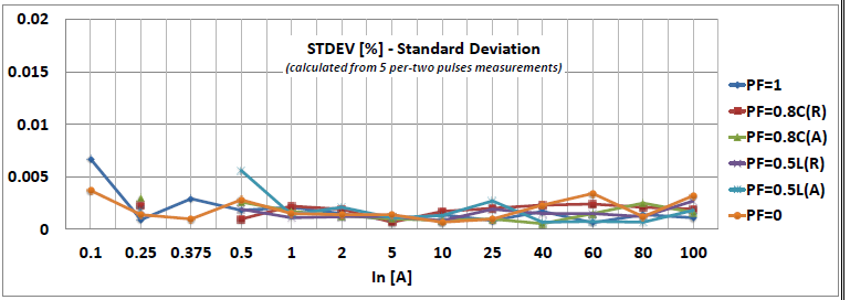

The second graph (on the bottom) shows the measurement repeatability; i.e. standard deviation of error of the measurements at a specific load point.
