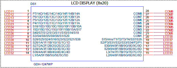

On NXP website we had provide an application note " Kinetis-M Two-Phase Power Meter Reference Design" which can been found here: http://www.nxp.com/docs/en/application-note/DRM149.pdf
This is really a quite useful solution for 2-Phase Power Meter design. From the schematic, there has a LCD display.
Many customer sent email to ask for the datasheet of this LCD display(GDH-1247WP). Yes agreed, it is really difficult to find it. ( Even from the google.) I am attaching the data sheet for the segment LCD here for customer to make reference.
