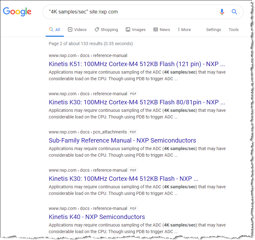

No special meaning for this data (4K samples/sec).
You can see other new version manual also include this:

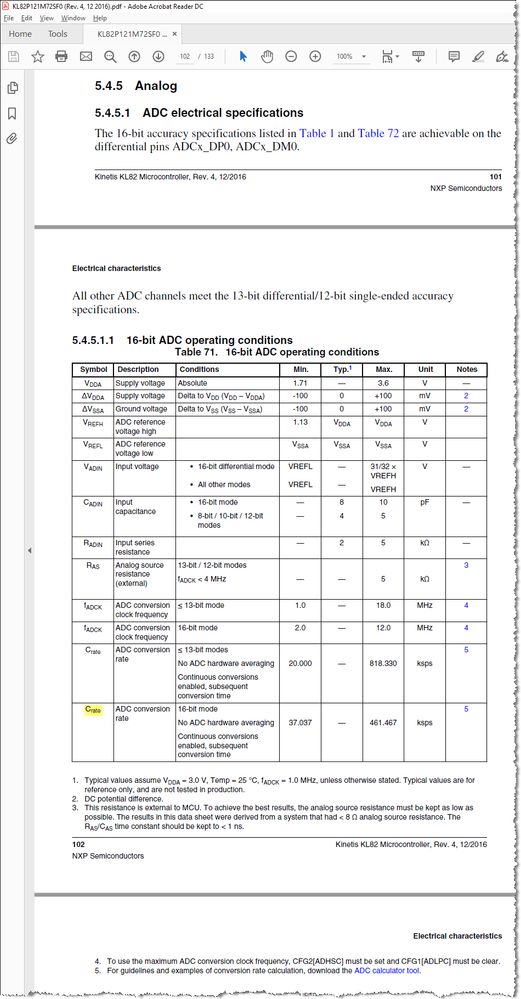

ADC data can be found in datasheet:
It just for tips: Using DMA move ADC result can reduce the load on the CPU for high sample rate continuous ADC use case.
Otherwise, you may have to manually move the ADC result data at a higher frequency.
