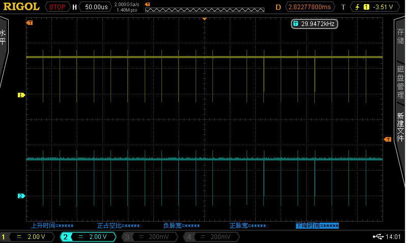

Because there is not KL04 board, I use FRDM-KL05 board, the KL05 and Kl04 are pin to pin compatible. I run your code without modification for the TPM0/TPM1 setting, and test FTM0_CH0(PTB11) and FTM0_CH1(PTB10), The output of the two signal is okay, I paste the screenshot from oscilloscope. As you can see there is not 50% duty cycle signals.
For your issue, how many boards have you populated? can you change another board to have a test? when you set the C0V as 798, does the 50% duty cycle appear always, frequently or sometimes?

I have tried my code on 3 different boards.  If the CxV value is 798 the duty cycle is ALWAYS about 50%.  My code is already setting TPM0 TOIE.  in main.c the function PWM_Run_Ramp() is triggered by the TPM0 timer overflow event.  That routine runs consistently regardless of CxV setting.  There's even a GPIO that you can uncomment in that function that will toggle at the beginning and end of the function.  If you do that you can see that the ISR runs consistently.  Also, it is within this ISR that the variable raw_duty is written to the TPM0 CxV registers.  If that ISR stopped running you wouldn't be able to update the duty cycle.
I tried the same test you did using a FRDM-KL05 board.  I'm not sure why you are not seeing the issue.  I still see it using this platform.  I suspect the problem is the value you are setting for raw_duty vs. which TPM0 channel you are looking at.  Look in the code in the PWM_Run_Ramp() routine.  As mentioned this is the ISR triggered by the TPM0 overflow event.  In the ISR there are two functions that are called PWM_Set_PWMACount() and PWM_Set_PWMBCount().  Each function takes raw_duty as input.  PWM_Set_PWMACount() sets C0V and C1V to MOD-raw_duty.  Since MOD = 800 you'll need to set raw_duty to 2 in order to get C0V and C1V to equal 798.  PWM_Set_PWMBCount() directly sets C2V and C3V to raw_duty.  This difference is what gives me the 180 degree phase shift that I need between the two sets of PWMs.  If you don't trust my code check the values of all of the CxV registers in the debugger window.  That's what I did to verify that I wasn't screwing something up.
One other thing to watch out for.  Within the two sets of PWMs, C0V/C1V and C2V/C3V only one of the PWMs is active at a time.  The other is set high.  The default when you start the PWMs by setting button2Count and button2HighAlert is for C1V to be PWM while C0V is high and C3V to be PWM while C2V is high.  This is done by changing the GPIO mux setting.  Based on that I don't see how the waveforms in your oscilloscope screenshot are possible without modifying my code.  If you were looking at the outputs associated with C0V and C1V they should never have both been active PWMs at the same time.
