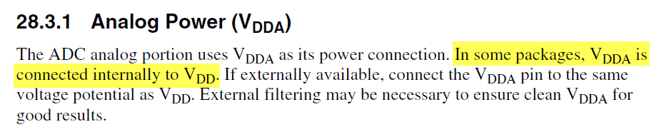

In the Kinetis KL03 datasheet, i don't see a pin for VDDA, only for VDD. Is VDDA internally connected to VDD? Thanks.

Hello Adrien:
That is correct, VDDA is internally connected to VDD when not available externally. This is from KL03 Reference Manual:
Regards!,
Jorge Gonzalez
