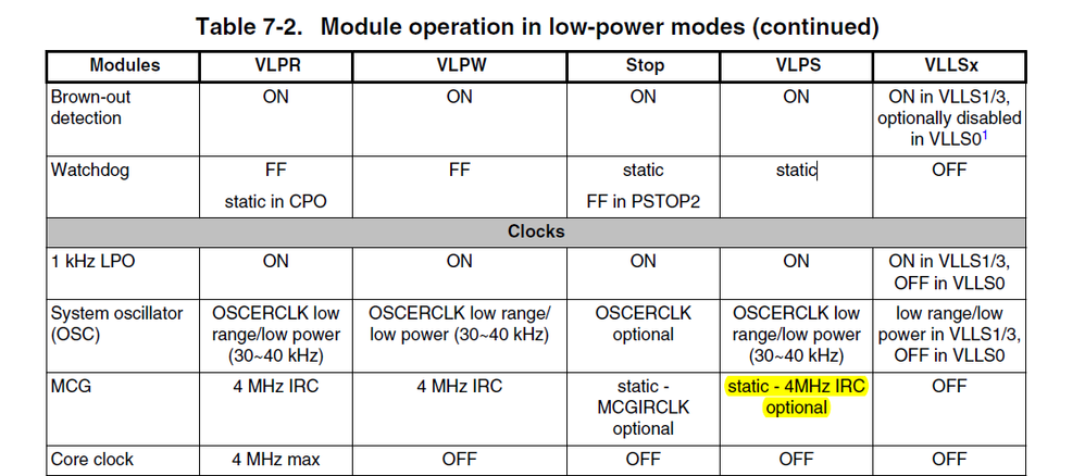

      You can't use internal 32 kHz clock source during VLPS mode, you just can use 4Mhz IRC clock as the TPM clock source during VLPS mode.
Because in VLPS mode, MCG state is static or 4MHZ IRC, you can find this in the reference manual.
Besides, if you want to use the internal clock 4Mhz as the TPM clock source
Just set IREFSTEN is not enough, you also need set IRCLKEN
you are not only need to set MCG_C1[IREFSTEN], but also MCG_C1[IRCLKEN ] and MCG_C2[IRCS].

I didn't read table 7-2 before.

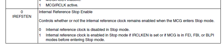

As Mark mentioned I assumed from reading table 5-1 that MCGIRCLK is active in VLPS when IREFSTEN is set no matter if it's the fast or slow IRC.
The register description "21.3.1 MCG Control 1 Register (MCG_C1)" also doesn't state that IREFSTEN only applies for the fast IRC.IREFSTEN.png

I can confirm the behaviour, which makes sense based on details in table 7-2.

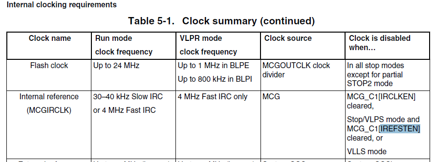

However table 5-1 is possibly causing confusion:
Here it excludes the slow clock only from VLPR mode [which is correct when the table handles only run mode and VLPR] but it states that the clock is disabled in VLLS mode and can continue running in STOP/VLPS when the correct registers bits are set.This now mixes the description with other low power modes and doesn't give information that it is only relevant for the fast IRC.
Only when understanding that this table is giving the rules for RUN and VLPR at the left and only giving partial details on the right - which then need to be "read together" with the low power mode rules of table 7-2 to get the overall rule set - does it all fall in to place.
Although it is not explicitly stated anywhere I uderstand that basically the slow IRC is stopped in ALL Vxxx modes so is only available in RUN, WAIT or STOP states.
