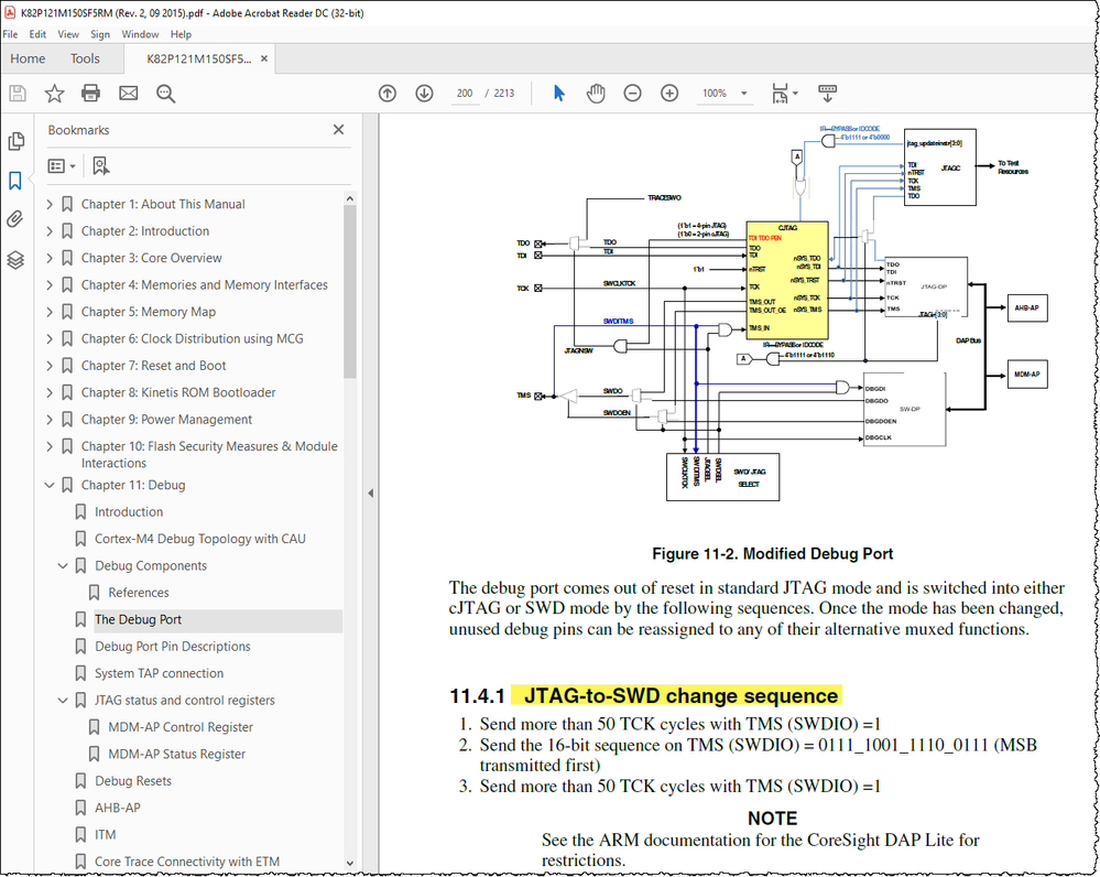

I see from the K82 Ref Manual that the Debug Port comes up as JTAG after reset. But I am working with a FRDM-K82F eval board, for early prototyping, and it is set to SWD. But I can't find where in any of the code the K82 Debug Port is changed from JTAG to SWD.
Can you tell me how this is done? As I will ultimately need to do this on our future board.

Hi greycon,
Please refer "11.4.1 JTAG-to-SWD change sequence" of Kinetis K82: 150MHz Cortex®-M4F up to 256KB Flash (144pin)
11.4.1 JTAG-to-SWD change sequence.png11.4.1 JTAG-to-SWD change sequence.png
OpenSDA(debugger) has done this.

Ah, openSDA - of course! Many thanks for your reply Robin.
