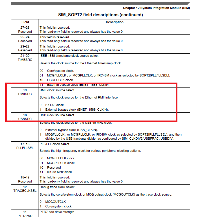

I'm using K64 microcontroller and I need to implement Ethernet , hence I'm using suggested PHY KSZ8081 and RJ45 JX0011D21NL .I want to know how to conenct REF_CLK with microprocessor as pin 72 ( PTA18/EXTAL0/FTM0_FLT2/FTM_CLKIN0 ) is being used by external oscillator to provide clock to microprocessor.
Can someone tell me how to set clock for syncing ethernet PHY and microprocessor?

We are using a cystal to program the microprocessor at this pin so its occupied.Is there any provision to synchronise MAC of processor with PHY Ref Clock.
2,044 Views
Kan_Li
There is an alternative clock source for ENET module, you may feed ENET_1588_CLKIN with 50MHz clock as the same as PHY Ref Clock. Please kindly refer to the following for details.
Hope that helps,
