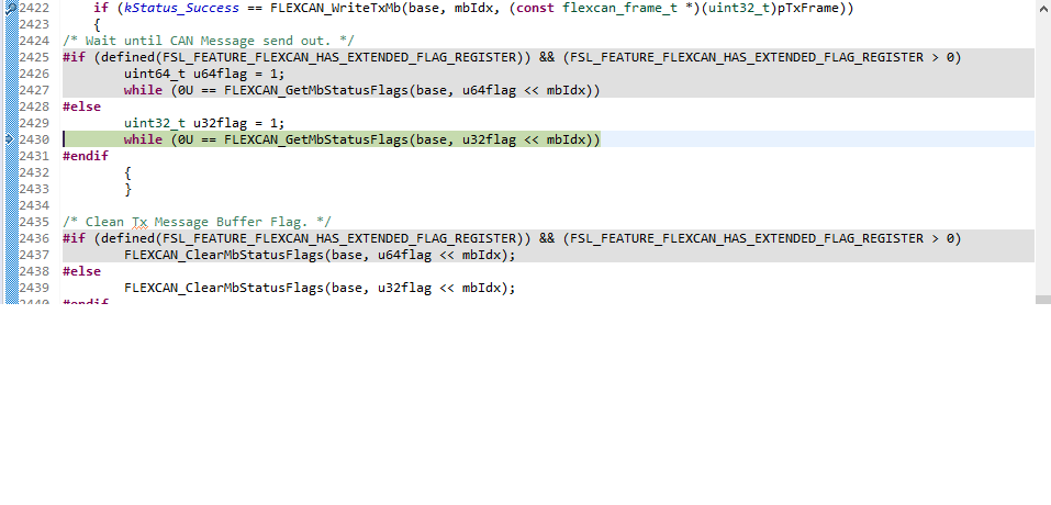

senthilprabhug
Fabio,
 i have same issue what you tell above. i have only one board configure as transmitter and i connect the CAN_H through the Transceiver to the CAN analyzer. i also disable the loopback and cinfig the pin mux. then i start debugging but message not send because of program stopped here.
while (0U == FLEXCAN_GetMbStatusFlags(base, u32flag << mbIdx))
the flag not set. are you facing this issue or not.
i attaced the pic for your reference.
I'm using MKV42F microcontroller. i do code with example of frdmk64_interrupt_loopback.
