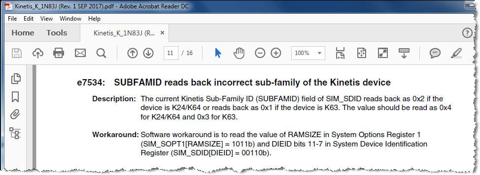

I’ve two FRDM-K64 Evaluation Boards here on my Desk and both of the controllers think they are a K62. But there is no Datasheet for the K62 … So what is it?
I’ve checked the SIM_SDID Register and got the following values:
PINID:    8            -> 100-pina
FAMID:  4            -> K6x Family (without tamper)
DIEID:   6
REVID:  1
SERIESID:   0     -> Kinetis K series
SUBFAMID:  2     -> Kx2 Subfamily
DAMILYID     6     -> K6x Family
Was the K64 first planned to be a K62 and I have old silicon?

Hi Markus,
Sorry for the inconvenience that has caused.
Please read the lastest errata of K64.
e7534: SUBFAMID reads back incorrect sub-family of the Kinetis device
Robin

Thank you for clarification
