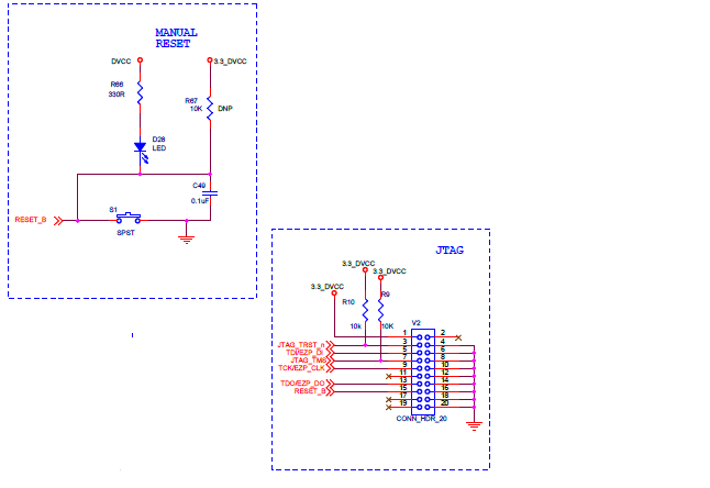

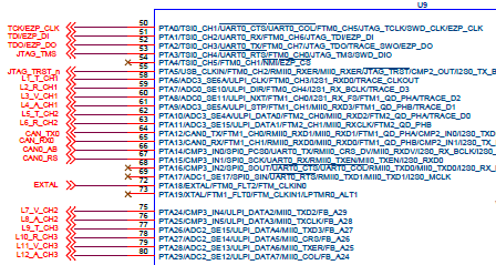

We checked reset pin voltage thats around .7v. Thats low level is it.we checked  PTA4 (NMI/EZP_CS) that pin shows low level.According to some discussion in community or datasheet .if that pin low ,we cannot program.So now we use pull up resistor 10 ohm to reset pin and 47 UF capacitor to gnd.NOW that RESET pin goes high approx. 3.1 v and EZP_CS pin also goes high But problem still remains:smileysad:.Now also we cannot  program the IC...please tell me as soon as possible.

lijofrancis
Dear sir ,
Thank you for response
i will attach the circuit
here in manual reset,  pin 330ohm,led and capacitor  was used but when reset pin goes low.Then we replaced that portion and the we use only 10 ohm resistor and 47 uf capacitor.then reset pin goes high but still we are not able to program.
we cannot program .Please reply me

jeremyzhou
I think there are some something wrong with the debug interface, please correct the debug interface by referring to the attachment.
I've also suggest to use the 1K ohm resistor instead of the R66.
Hope it helps.

lijofrancis
Dear Sir,
We took the schematic from K60 Tower board.we are able to  program the IC first time.At that time using(330ohm,and led and capcitor),reset pin voltage is 1.42 v.that time we can program succesfully.After some we same external circuits(SPI,analog in..) the reset pin voltage drops ,we cannot  program.But when we use in place 10 ohm with 47uf ,reset pin goes high.but not able to program.
