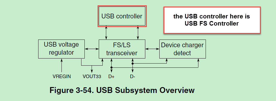

sherry_zahid
Hi Ma Hui,
Thanks for your response, however I still need to know :-
I am using the following pins for ULPI USB interface
ULPI_DATA[7:0]                                                          For data
ULPI_CLK, ULPI_DIR, ULPI_NXT, ULPI_STP             For control signals
Q) I am using the above pins to connect to USB ULPI and I am not using OTG. So do I need to power VREGIN and VOUT33 or do I have to leave these 2 pins floating?
(Asking because of the note on pg. 153 of reference manual "When USB is not used it the application, it is recommended that the USB regulator "VREGIN" and "VOUT33" pins remain floating.")
2,173 Views
Hui_Ma
Please check the USB FS Subsystem overview diagram:
For customer doesn't use USB FS controller, the VERGIN and VOUT33 pin can be left floating.
Wish it helps.
