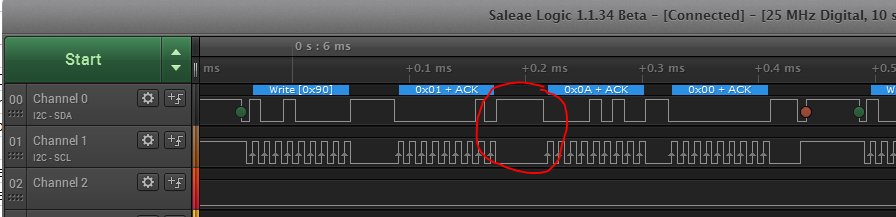

We are using Kinetis K and have encountered a problem which seems exactly as the known one in Kinetis L, but it doesn't appear in our Kinetis K erratas.
What we see is exactly the same behavior and working behavior as explained in mask set errata 2N97F, ID 6070, title: "I2C: Repeat start cannot be generated if the I2Cx_F[MULT] field is set to a non-zero value".
We are using Kinetis K MK11/MK21 and both don't have this errata published on the web site.
Is this a known issue for the Kinetis K devices or we have are missing something here?

Hi Erich, I believe I'm seeing this exact problem on my K64F, but I'm not positive.  However, the problem I've got is that I can't make the changes you've suggested because I can't find them in PEx.
By any chance is that option selected elsewhere in KDS 2.0?
I'm doing a write here, rather than a read.  Perhaps I'm barking up the wrong tree, but I was trying to figure out if there's a way to force the repeated start when I found this post.  The chip I'm using specifies that I either send a STOP or repeated start after the 0x01 in the image above.

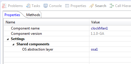

that means you are using the Kinetis SDK? I believe it is in the clock manager, but not sure.
8,909件の閲覧回数
dave408
Senior Contributor II
Yes, I'm using KSDK as well.  I have disabled tabs and am going through each item in PEx, but nothing jumped out at me.  I looked at the clock manager and there's nothing really there.
There are a lot of clock-related settings for the CPU, but I never know what is safe to play with there.  Usually, I delete all configs except for the "maximum speed" config, but at the moment I have all five available and I'm using #1 (max speed).
8,908件の閲覧回数
BlackNight
This is handled in the SDK source code, and I believe you cannot influence this with the settings in the components. You would need to check the SDK source code.

When we reconfigured the prescaler to 0 (divide by 1) while remaining the same resulting I2C frequency (with the help of PE), it started working correctly.
