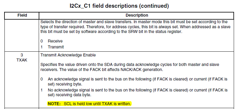

I am trying to track the mechanism in which the K10 will pull the SCL line low on every clock cycle when it's transmitting back to the master.  From the datasheet, it appears that the SCL line should only be actively driven (see datasheet snippet, below).
We always have TXAK=0 and FACK=0, only sending one byte at a time.

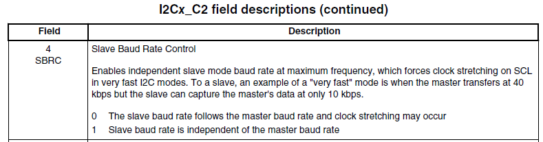

Does anyone have an idea of why the K10 would massage the SCL line as a slave like this?  I have tried to manipulate the SBRC bit to see if there was some clock stretching or such occurring but this bit didn't prevent the pull-down from happening.  I have also copied that portion of the datasheet (K10) that mentions the SBRC field.

The problem is then very strange. Are you confident that those low spikes are caused by the K10 and not the isolator?
When configured for slave mode, the K10 should never drive low the SCL line, unless it is trying to stretch the clock, but I don't think this the case. Can you try with a lower I2C frequency from the i.MX master side? What is the core frequency of K10?
