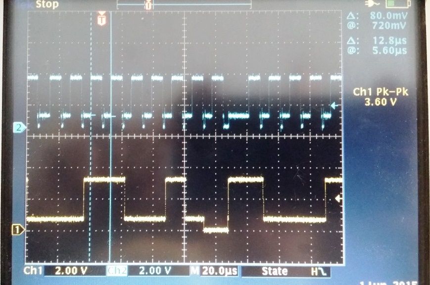

What we are experiencing is an I2C bus lockup especially during EMI/EMC testing (EFTB is a major culprit, 2kV).  Troubleshooting has led us to believe it is a combination of the K10 and the Si8606, although other isolators are supposedly susceptible to similar lock-up.  Where the K10 might be affecting this is when it actively tries to drive the SCL line, even though it's a slave device.
We are observing the K10, in slave mode but when transmitting back to the master, the clock line being periodically pulled low just past the switching of SCL low on the SoM.  Because of the voltage differences on the A-side of the isolator, the VOL of this side is about 0.9V so as to not trip the A-side reading of an input LOW.  There needs to be a minimum 50mV difference between A-side and B-side lines to achieve the anti-lockup condition.  Please refer to the photo, below, to see where we believe the K10 is pulling the A-side SCL line low (and B-side is also low, being driven by the SoM).
(top: SCL, bottom: SDA; both taken on K10 A-side of Si8606 isolator)

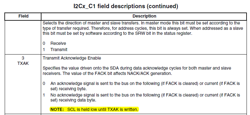

I am trying to track the mechanism in which the K10 will pull the SCL line low on every clock cycle when it's transmitting back to the master.  From the datasheet, it appears that the SCL line should only be actively driven (see datasheet snippet, below).
We always have TXAK=0 and FACK=0, only sending one byte at a time.

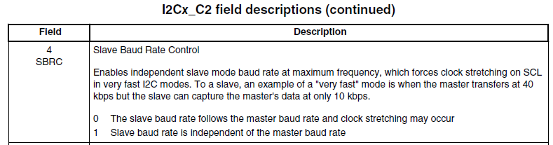

Does anyone have an idea of why the K10 would massage the SCL line as a slave like this?  I have tried to manipulate the SBRC bit to see if there was some clock stretching or such occurring but this bit didn't prevent the pull-down from happening.  I have also copied that portion of the datasheet (K10) that mentions the SBRC field.

The problem is then very strange. Are you confident that those low spikes are caused by the K10 and not the isolator?
When configured for slave mode, the K10 should never drive low the SCL line, unless it is trying to stretch the clock, but I don't think this the case. Can you try with a lower I2C frequency from the i.MX master side? What is the core frequency of K10?

Well, Jorge, that's certainly a valid question, and one that I've asked myself--especially since there are multiple slaves on the I2C bus.
But on the side of the isolator that this scope capture is from, this is on the K10 side.  I haven't put our logic probe on this proper (but have other captures with the I2C sniffer) to see if this particular packet is indeed from the K10, but I suspect it is since it's located directly on the K10 side and no other slaves are on this side of the isolator.
But, I can't 100% rule out that the isolator is not doing this.  It *shouldn't*, though, because the VOL is about 0.9V and if it is driving the line <0.7V it is subject to latch-up.  Still, I am getting ready to probe the input vs output relationship of the isolator to ensure a > 50mV differential.  This may tell me if the isolator is actually causing that blip.
