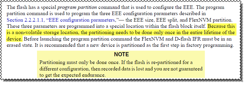

There is no workaround for the mass-erase. The partitioning is supposed to happen only once.
In application note AN4282 - Using the Kinetis Family Enhanced EEPROM functionality chapter 3.1 you will find the next:
Hope this is useful.
