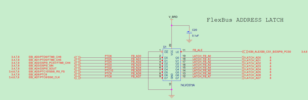

Hi Dudi,
In general, the Flexbus without using FB_CLK signal, which is just a asynchronous bus.
It just using FB_ALE rising edge to latch the address signals, such as TWR-K20D72M board using 74LVC573A latch device:
Wish it helps.
