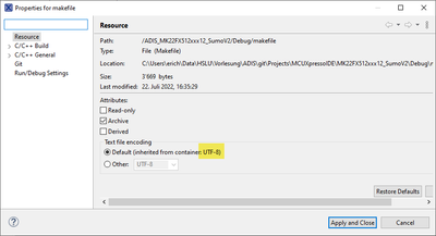

that one looks ok. But is your setup with different machines (e.g. Mac and/or Windows)? I have seen issues and reports for cases where say on the MacOS machine a different file encoding is used?
Can you check the encoding of your files and folders, especially the one of the make file itself? It should be UTF-8.
