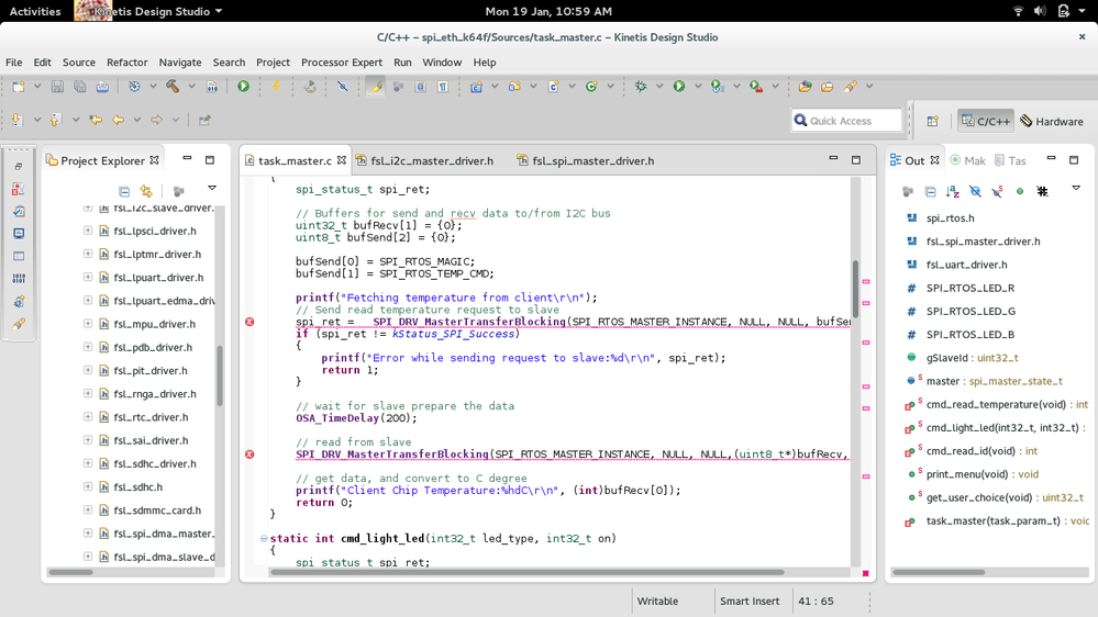

I am using KDS with KSDK, when included on my project spi, i have a error: 'undefined reference to  'SPI_DRV_MasterInit'', but i am including  #include "fsl_spi_master_driver.h".
what's is problem?
Screenshot from 2015-01-19 10_59_47.pngScreenshot from 2015-01-19 10_59_51.png

Hi Edwin,
This is definitely a problem with paths, but I am not sure is compiler paths or linker paths. I assume linker.
Please take a look to the following document which indicates all the paths required for a full working KSDK application.
Writing my first KSDK Application in KDS - Hello World and Toggle LED with GPIO Interrupt
