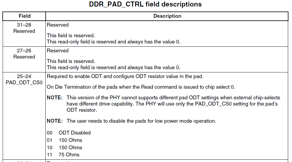

I'm trying to configure the DDR interface in a Kinetis K61 but I'm struggling with the correct settings for the DDR_PAD_CTRL register.
How should one chose correct settings for the SPARE_DLY_CTRL bits? The documentation (reference manual K61P256M150SF3RM rev 2) doesn't explain how the buffers correlate with the behavior of the DDR PHY.
What is delay chain #0?
What is spare logic?
What are buffers?
It is also confusing to see that the reset value for the reserved bits [8:15] are set to 0x2 when the documentation says "This read-only field is reserved and always has the value zero." This is obviously not the case as I can read a value != 0 after reset.
All in all this register lacks documentation needed to understand how it should be used.
Our setup is in all aspects identical with the TWR-K70F120M board and in the code examples we can find the SPARE_DLY_CTRL is configured to "10 buffers", why is that?

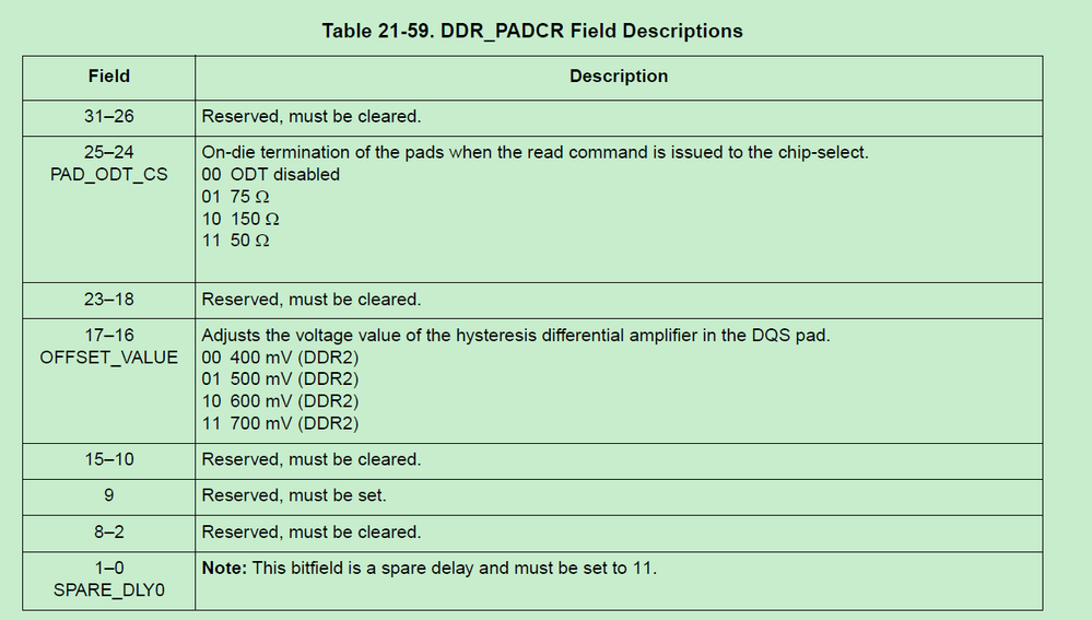

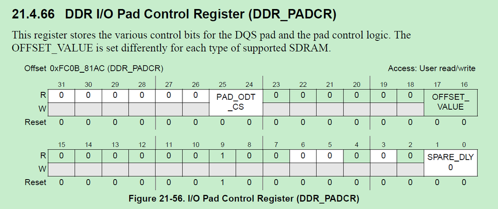

Kinetis K70 is using same DRAM controller IP of ColdFire MCF54418, and I checked MCF54418 reference manual about DDR I/O Pad Control Register (DDR_PADCR) register with below description:
That could interpret the K70 DDR2 initialization code of DDR_PAD_CTRL register value:
DDR_PAD_CTRL = 0x01030203;

However, I find that the descriptions for PAD_ODT_CS0 is different for the K70. Can you please explain which one is correct?
2. In trying to use the K70 DDR configuration tool, I cannot seem to determine how the parameter io_odt translates to a value in the DDR_PAD_CTRL register in the generated code. I've played around with different values. I originally thought it may just be in Ohm units. So I tried 0, 50, 75, and 150. All but 75 return bits 24-25 in DDR_PAD_CTRL as 0, where having io_odt = 75, returns bits 24-25 as 1. This doesn't match the specification detailed in the reference manual (shown above). I also tried values io_odt from 0 to 3, assuming that the tool might just mask the value and slot it in the appropriate fields in the DDR_PAD_CTRL register, but again, they all returned 0 in bit 24-25.

Looks like you're right about that particular register and that it is the same as for MCF54418. It does explain DDR_PAD_CTRL = 0x01030203;

Coming back to the DDR_PAD_CTRL register, yes the SPARE_DLY_CTRL is configured to 10 buffers but the tool generates this code:
According to the RM (K61P256M150SF3RM) bit 16-17 are reserved and so are bit 9, why does the tool set these values??? (Bit 9 should be cleared according to the manual)
