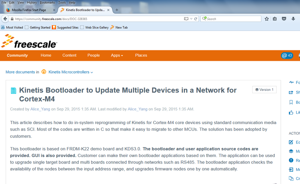

Sorry, I should have been more specific.  I can download the two documents, but there's another document referenced in the post itself -- were you able to get to it as well?  I'm using a Cortex M4, and since I'm not an expert with ARM, I thought that the M4-specific info would be more appropriate for me.
Hi dave,
I clicked on the link to the referenced doc, it brought me to a sign in page and I signed in, then it gave me this error message:
Unauthorized
Access to this place or content is restricted. If you think this is a mistake, please contact your administrator or the person who directed you here.
So, no, I can't get to the Cortex M4 document either.
Rich.
Ok, that's what I got as well.  Thank you for checking!
strange. I just tried i can get to this link:
I will check it with the poster.
thanks for let me know it.
Jennie

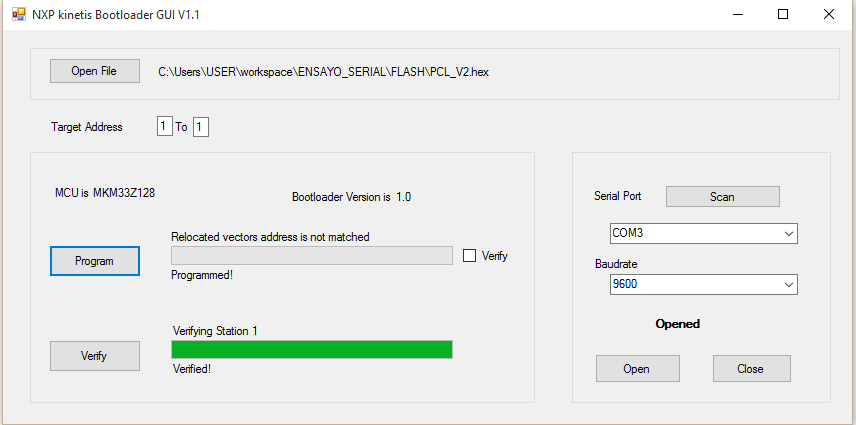

hi  ZhangJennie
I get an error loading .HEX file , Do I need to modify CW source code?  Or what I must to do?pastedImage_1.png
Current time is 17/02/2016 8:38:06 a. m.
The s19 file is: C:\Users\USER\workspace\ENSAYO_SERIAL\FLASH\PCL_V2.hex
Station 1 is trying to enter Boot mode
Error 1 times!
Error 2 times!
Error 3 times!
Hi Fabrice,
from the error messsage "relocated vector address is not matched". this is due to the GUI recorded relocated vector address is not as same as the app hex file defined one.
what's your app code vector relocation address? please check your target bootloader and app code.
when click GUI "program" button, MCU bootloader will send 'I' command to GUI. this command includes app relocation address which is memorized by GUI as a standard one.
please make sure these address definition are matched.
Jennie
Hi ZhangJennie
the problem is that if I upload the file s.19, works correctly but if upload .hex it does not work, the relocate vector is 0x1000
thanks
Andres
can you please send your bootloader, app project. and s19, hex files to [email protected]
I will check. thanks.

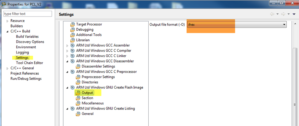

HI Andres,
I received your files. the PCL_V2.hex that included in your package is not hex format, you can see it by open with notepad.
hex format should be something like this:
I use your app project generate a hex format file, it can burn flash with new GUI v1.1 without problem.
please make sure you enable hex formation generation for your app project to generate correct hex file.
let me know if this can help you.
Jennie
