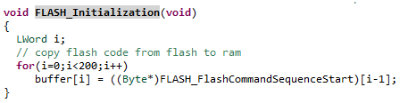

Dear Alice, I was analyzing your code to understand how to develop my owm specific bootloader. I was looking many Freescale AN's, examples, etc. Your seem to be better. But I will need some help from you.
1) in your code...
for(i=0;i<200;i++)
     buffer[i] = ((Byte*)FLASH_FlashCommandSequenceStart)[i-1];
[i-1]      it will generate a error, because i start with "0".. is it correct ?

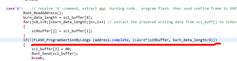

2) My code need to execute from RAM  memory, to erase all flash memory and read the new firmware from a pre-programmed external SPI flash and put o K63 flash memory.
3) Can you help me, teeling what is the command that write on flash ?
4) How can I put a bootloader fuction on RAM, copying it ? And what will hapen with  some command that points to a flash memory instead of RAM memory ?
Can you help me ?
Best Regards
Rodrigo
Hi Rodrigo,
Sorry to reply you late !
Thank for interested in this DOC.
1) Could you please tell me what error you generate ?
And in fact ,the FLash command start from the buffer[1] , you can find this code :
#define FLASH_FlashCommandSequence ((LWord (*)(Byte))&buffer[1])

3)"Can you help me, teeling what is the command that write on flash ?" ?  What do you meaning ?
In my project , the write to flash code is here :
and the flash write command is :
FLASH_FlashCommandSequence(PROGRAM_LONGWORD_INDEX);
#define PROGRAM_LONGWORD_INDEX  8

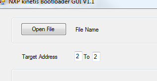

In bootloader.c file I found the following line of code "const Byte station_number = 1;" which should be the bus address of the device right?
I programmed the two devices as station_number 1 and station_number 2 and tried updating. But it seems that both devices are responding to both addresses. In single device mode station_number 2 also responded to address 1 in GUI...
Do you know what I'm doing wrong? Where I have to specify the bus address of the devices?
Hi Sebastian,
Thank for you interest for this DOC.
And sorry for one error on my project i attached, now i have attach the new one, please use the new one.
About the station number , you need change two place,
one is in the file of "bootloader.c" :  const Byte station_number = 2;
another is in the User Application project , in the bl_mommunication.c file :   const Byte station_number = 2;
Then  if you want flash to the station 2, on the GUI, please select 2 to 2, this meaning only flash the 2 .

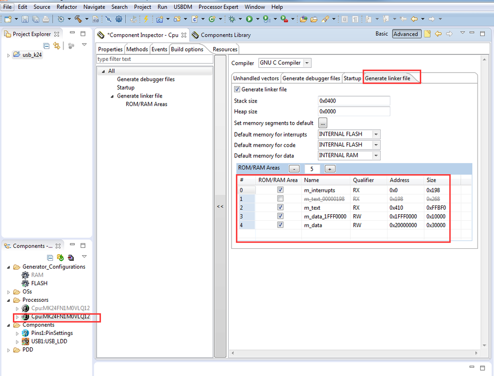

I was curious if you could provide some guidance upon how to configure a Processor Expert (PE) created project (KL26 processor) for use (PE based user application) with your GUI/Bootloader?  I ask, as PE generates a CPU.C file that contains some Flash Configuration values which appear to conflict with where your sample application stores the "APP_OK" signature attribute (in section ".cfmconfig").
Thanks in advance!
Cheers,
Sam
Good day All,
Just a follow up to my original question...  If you are using PE you need to turn off Linker File generation in order to correctly update the liker file.  In particular the m_cfmprotrom segment... which is not directly accessible within PE.  Secondly, you need to manually rename the resulting S19 record file from CW's default extension of ".hex" to ".s19" (Alice's Window's program inteprets the ".hex" file differently).  Upon doing this I am able to use the Bootloader and GUI Windows Loader.  I still have more testing to do, but at least I now have a basic working system!
Thanks to Alice and the team for this Bootloader infrastructure.
Hello Sam,
Thank you for your interest in this bootloder .
- The User Application can be any project (PE project and  bare board project both are ok),
we only need refer to the part of "3.3.8 User application code" to configure the application project .
Yes , if you use PE project , change the linker file directly , you need turn off Linker File generation.
And you also can configure it in "Generate linker file" configure view :
