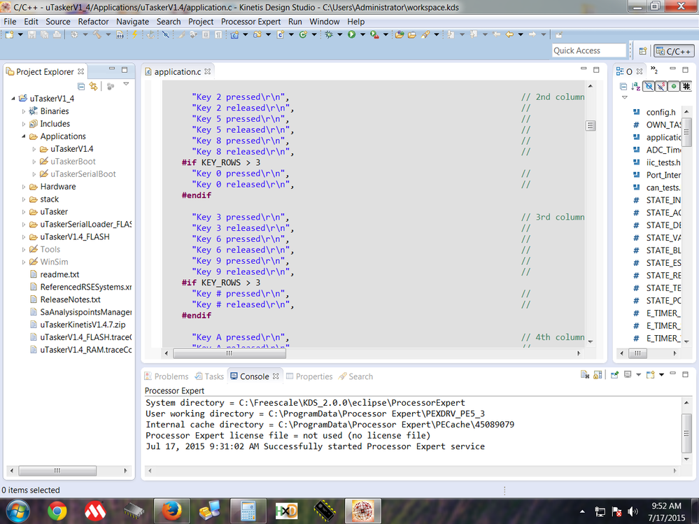

sudhakarp
Contributor V
hi mark,
     i tried to build bootloader code in KDS 2.0 but i cant change properties setting. i attached image. in tool setting menu there is no option its simply empty. i tried to add image but i cant some forbidden  error came.
i cant see targer processor option and ARM LTD windows GCC c linker option. give some idea.
     thanks and regards,
sudhakar p

mjbcswitzerland
Specialist V
Please read the first step in the instructions and/or the readme.txt file in the root directory that explains using the correct eclipse project files:
Quote:
"To import the µTasker project into KDS the following simple steps can be followed:
    • To prepare the KDS import (as opposed to CodeWarrior or Atollic) start by deleting the directory ".settings" in the root directory of the µTasker project (the root directory the folder where the project was extracted to including directories "uTasker", "Hardware", "Applications" etc.) as well as other files at this location which begin with a '.' (eg. ".cproject") since these may be for alternative Eclipse based environments.
  • Now copy the KDS project settings from the folder \Applications\uTaskerV1.4\KinetisDesignStudio\Project_Settings to the root (these are the directory ".settings" and files ".cproject", ".cwGeneratedFileSetLog" and ".project").
    There is also a read.me file at that location explaining the procedure and why it is necessary. If you already know and are sure that the KDS files are located in the root these steps are of course not necessary."
Probably there is a CW .project file in the root and it can't be opened by KDS (and vice versa).
Mark

     Now i got it. (for make sure) actually my understanding bootloader code will be from
0x00000410 to 0x00008410  and my application will start 0x00008410 am i correct..? actually nearly 32KB for bootloader code am i right.
     AND  also i tried to go through serial bootloader code. but i didnt get which place its jumbing to Application code and which condition its jumping and all. in KDS its All Serial bootloader file are showing like hidden  files.
only utaskerv1.4 only showing like original files (i mean that color difference). i cant find serial bootloader code main function.
project explorer u can see the difference. i planed to edit bootloader code depends on my requirement
7,954 Views
mjbcswitzerland
Specialist V
The target is not always shown correctly in KDS - this is due to a stange default configuration that it uses, but it can be corrected by changing the setting as described here:
KDS not correctly displaying files belonging to the active target
Then you will see the correct files as used by the serial loader target. Even when the files are shown greyed out they are still used and built correctly.
The serial loader occupies the Fash space 0x00000000 to x, where x is the size of the binary file generate (look at the size that is generated with your IDE/compiler by simply viewing the binary file size in Windows explorer). With Ethernet and SREC functionality it will be about 24k in size. The default settings are to have the application at 0x8080 but these can be changed if desired.
Your appliation needs to be linked to the start address (default 0x8080 - where the reset vector is located).
The code responsible for jumping to the appliation is
start_application(_UTASKER_APP_START_);
Mark
