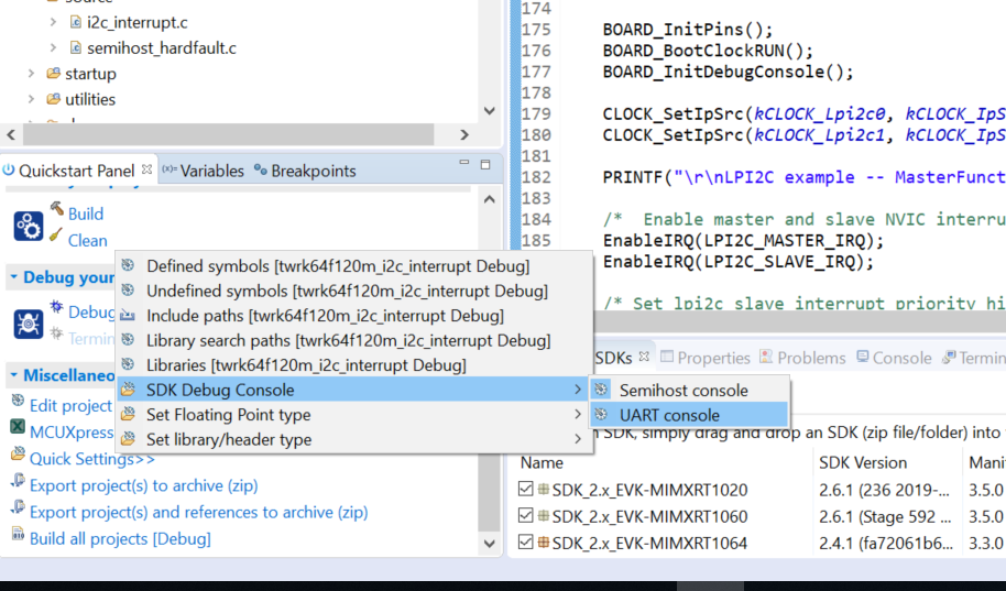

As mentioned on Page 13, when I press "Resume" button, I can see "hello world." printed on MCUXpresso IDE Console, but I am not able to see same on serial port, in my case it is COM15 and shows as: "mbed Serial Port (COM15)"  in windows "Device Manager".

From version 2.4, SDK doesn't support KDS anymore. If you want to use KDS, you should download 2.3 or 2.2. NXP hope customers use MCUXpresso. KDS is fade out.
MCUXpresso default use semihost to print debug information.  This is support by ARM debug component inside ARM core. If you want to print through UART, you can set it by right click Quickstart Panel-> Quick setting->...

With migrating to MCUXpresso IDE and SDK 2.6.0, I am able to write, compile and execute application.
Also with changing SDK debug console to UART as above, I am able to see logs on COM port as well.
