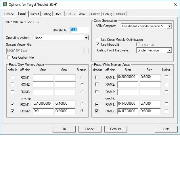

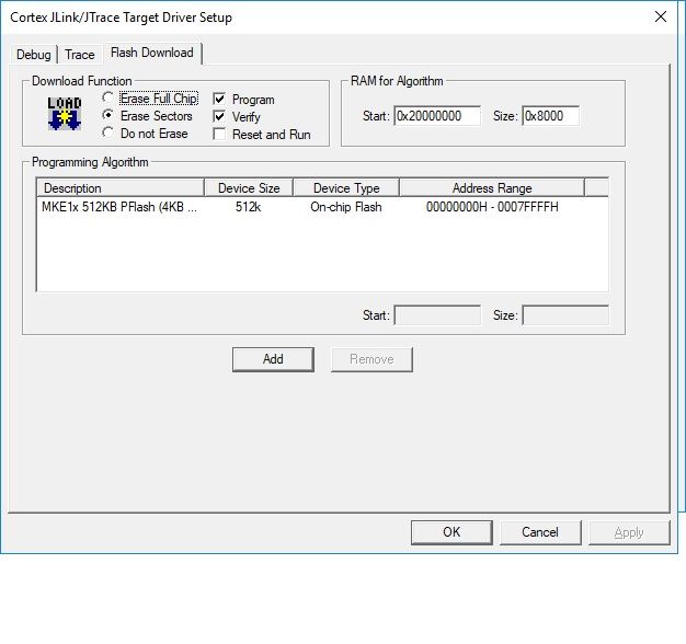

I am working on a custom board with the Kintes MKE14F512VLL16 microcontroller. I started out by developing some basic code on the evaluation module (i.e TWR-KE18F) which has the MKE18F xx series part. After my board was ready i am trying to make changes to the existing project to move it to the MKE14F part number. I have made most of the changes to the source code and drivers as needed but i am unable to download the code into my board.
I am using Segger JLink Plus debugger and Keil microvision IDE.
It appears to be some type of project configuration issue pertaining to the RAM allocation. I am able to successfully erase the chip using the same settings.
The error log is below and project configuration screenshots are also attached. Any help will be greatly appreciated !!

**JLink Warning: Could not read memory location 0x20000000 when trying to set soft RAM BP
Cannot setup Breakpoint at Address
