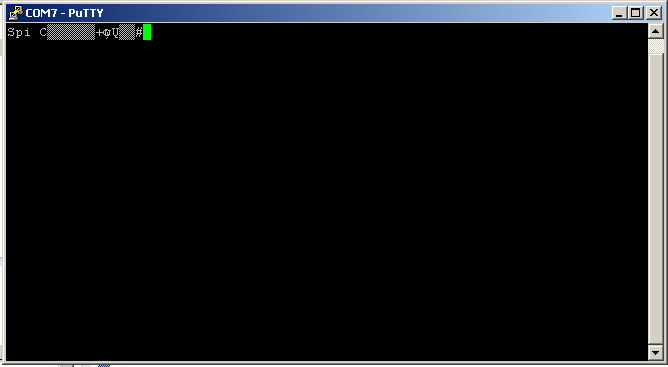

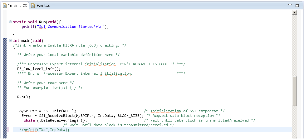

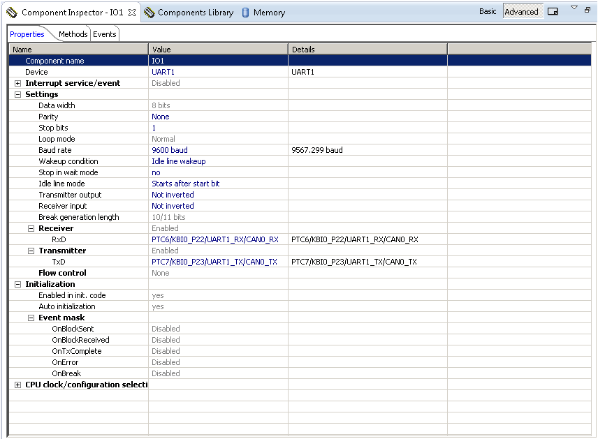

Im trying to build spi to uart bridge using frdm ke06z board using Processor Expert.I can read data from the master correctly but i can not see the data or anything correctly from the terminal.This project have done with ke02z board but ke06z is not working despite every settings is the same. Here are the some screenshots.Putty and boards uart configrations are also same.

I don´t see any mistake, can you send me your project to see what is  going on and give you the right answer.
