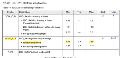

What we did - Provided power supply to its J8 pins. And did necessary pin config to provide supply using same. Board is configured in Both DCDC Buck as well as Bypass Mode, behaviour is same. Decreased voltage by 1V in step. LDO_CORE generating 1V.
What I observed - When we provide supply from J8 and drop voltage, everything works fine but once we reach 2.1v the RF drops.
I also checked till 2.2V the SYS_LDO generate an output of 1.8V but as soon as we reach 2.1V the LDO generate 1.7V.

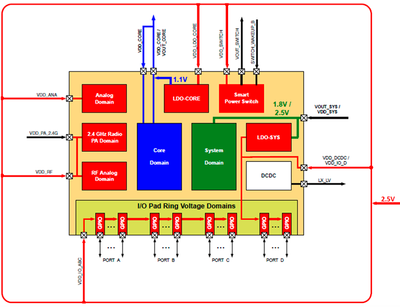

Additional Detail - I checked the HW recommendation guide and it shows that SYS_LDO supply power to System Domain. In both cases DCDC and Bypass.
The LDO_SYS output states it can output 1.71 to 1.98V at Normal Drive.
Additionally, it can Automatically passthrough once voltage reach to 1.98
System Domain Spec - The System Domain spec says in Normal mode it needs VDD_SYS of 1.8V to 1.98V.
Question - When I give input voltage of 2.1V, the SYS_LDO output is ~1.7V which is lower than requirement of System Domain, and as my passthrough will work only in case when voltage reach ~1.98V the System Domain will not get enough voltage to work? Is this the case?

We discovered the issue on Custom Board, it seems the Decoupling Capacitors on VDD_SYS and VDD_CORE are the root cause as we have not installed those considering the power is provided internally by LDO.
About NXP Dev Board - EVAL Board, I am not still sure why it disconnect.
