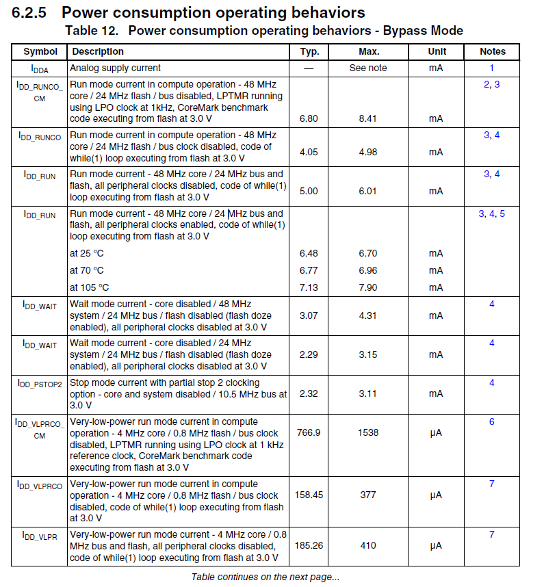

I would like to know the max current when VDD is 3.3v in KW36, but I could not find it in datasheet.

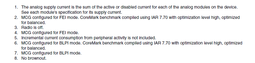

nxf56274
May be this will help you.
TIC
3,644 Views
jictannu
Hi, I think the max supply current is unclear in this table.
3,644 Views
nxf56274
The notice 2 has said the analog supply current is the sum of the active or disabled current for each of the analog modules on the device. We should see each module's specification for its supply current.
