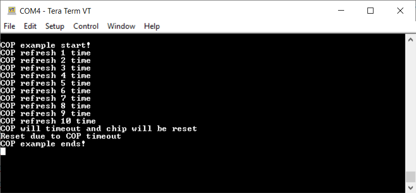

nidhintomy
Hi @EduardoZamora
I Tried with kCOP_LongTimeoutMode . But it immediately reset the MCU.
If i am selecting kCOP_2Power10CyclesOr2Power18Cycles as timeoutCycles, then i got first 4 prints in the code given below.
        for (uint32_t loopCount = 0U; loopCount < 10U; loopCount++)
            COP_Refresh(SIM);
            PRINTF("COP refresh %d time\r\n", loopCount + 1U);
Nidhin
5,425 Views
EduardoZamora
Just to confirm this behavior, please try the driver_examples_cop example project from the SDK. You should notice that immediately after getting the COP default config, timeout mode is overwritten (from LongTimeoutMode to ShortTimeoutMode):
Please, skip/comment/disable this line and test the application selecting kCOP_OscErClock / kCOP_BusClock as clock source.
