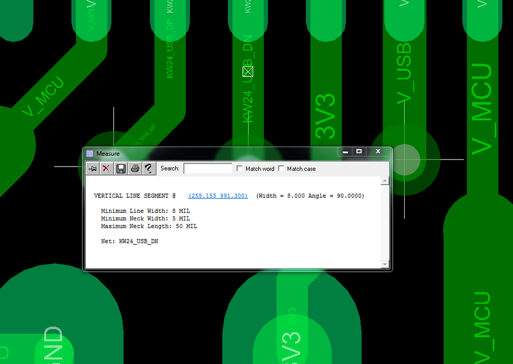

Greetings Kinetis experts,
I have a quick question. Is there a special reason why USB stick of KW24D512 has single ended impedance of 70 ohm and not 50 ohm for all lines?

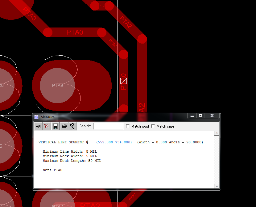

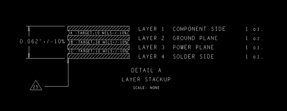

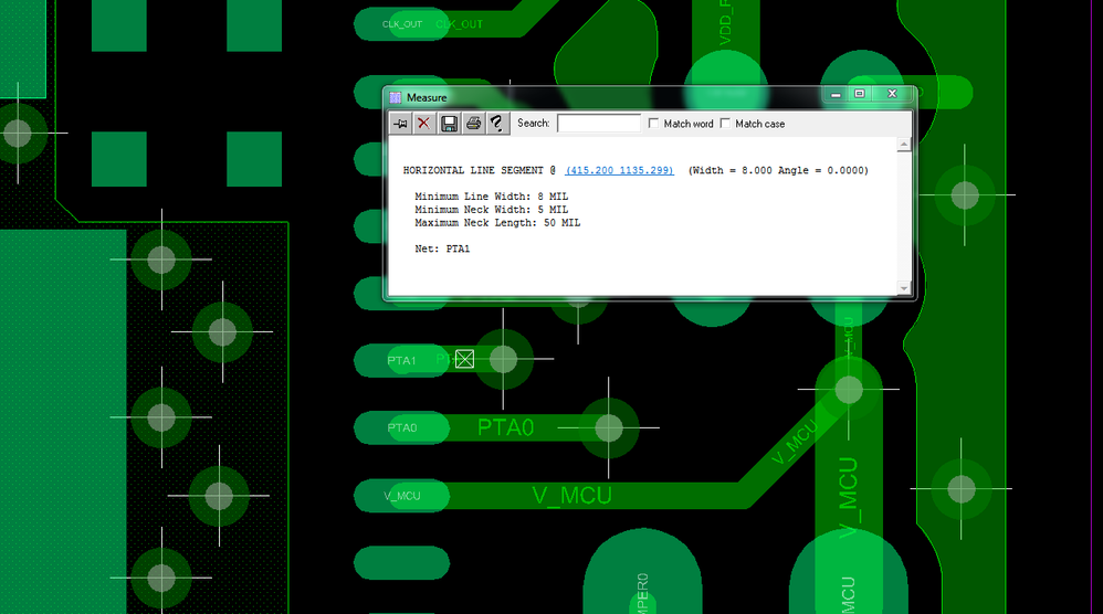

Please find attached pictures, All are from LAY-28057;
Width = 8.000 tracks, combined with the stack-up supplied are 70 ohm single ended impedance for the board.

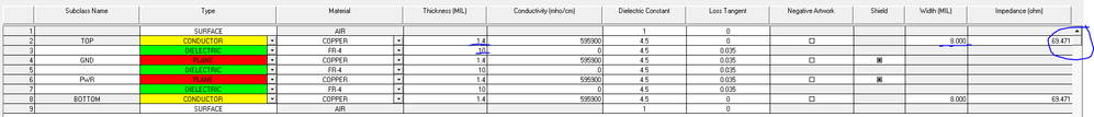

Thanks for your reply. When the below stack up is used for the board (from the open source .brd file)
Signle ended impedance of 8 mil lines become as follows (you need to zoom in sorry)
Am I missing anything? Different dielectric perhaps?
