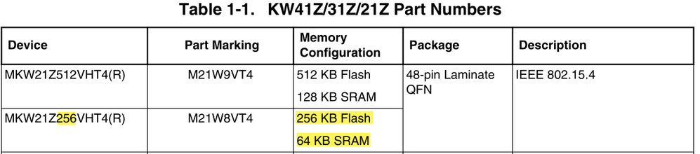

neal_jackson
In the reference manual, it indicates that the KW41Z/31Z/21Z all have their RAM region start at 0x1FFF8000. The linker scripts generated for the KW21Z 256/64 when using MCUXpresso uses 0x1FFFC000 instead. Linker scripts generated for the KW41Z have RAM at the expected 0x1FFF8000. My application hits a hard fault immediately if I change this to 0x1FFF8000 as mentioned in the reference manual.
Why is this different for the KW21Z 256/64? Does this mean the amount of available RAM is less than 64KB?
Thanks for any insight you can give.

Hello Neal Jackson,
The MKW21Z256VHT4 has 256 KB Flash and 64 KB SRAM, as indicated by Table 1-1. in the RM.
The address ranges are dependent on the size of the SRAM, where the SRAM_L region contains 1/4 of the total SRAM and the SRAM_U contains the other 3/4. So, the valid address ranges for SRAM_L and SRAM_U are then defined as:
• SRAM_L = [0x2000_0000–(SRAM_size/4)] to 0x1FFF_FFFF
• SRAM_U = 0x2000_0000 to [0x2000_0000+(SRAM_size*(3/4))-1]
Resulting in:
• SRAM_L = 0x1FFF_C000 to 0x1FFF_FFFF
• SRAM_U = 0x2000_0000 to 0x2000_BFFF
This is why MCUXpresso uses 0x1FFFC000 and will hit a hardfault if you change it to 0x1FFF8000.
Hope this helps!
Gerardo

Hi Gerardo,
This makes sense, thanks for the explanation!
