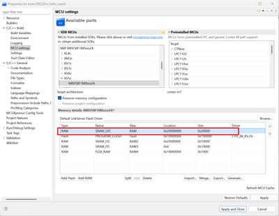

Thank you for your post. Unfortunately, we don’t have Green Hills or the Green Hills probe available, so I’m unable to try it on my side. I tested using MCUXpresso and our SDK, and everything worked fine. SDK can be found here: Select Board | MCUXpresso SDK Builder. The test steps were as follows:
1. Import the SDK “Hello World” demo into mcuxpresso
2. Set the “Link application to RAM” option
3. Move RAM to position 1
4. Compile and debug
Everything ran without issues.
